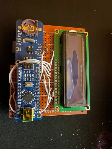

I have a nano with a Deek robot SD data logger. The SD seems happy. I am having problems with the LCD. I don't know if the logger is interfering.
I think pin 10 is for the SD and 11 and 12 might be used so am avoiding those. For the LCD I am using:
//RS, EN, 4, 5, 6, 7
LiquidCrystal lcd(6,7,5,4,3,2);

The SD seems to be working but nothing shows on the LCD, it just sits there glowing.
Think it might be a problem because of the data logger, any ideas?

Thanks, that's great, a 390R did the trick. I have data on the screen but it's just solid blocks across the top line. I still have an issue somewhere, will keep looking. I will double check all my connections but I still worry the SD is causing an issue...
Sorry, that does not make sense. :worried: Blocks are not "data".
Perhaps a photo?
Should have said visible character blocks.
Other people have had this issue. Am looking into it.
Thanks for help.
OK, so your contrast is set reasonably correctly but you are not actually accessing the display.
I think we may need a picture with sufficient detail to follow where the wires go, as well as the actual code.

But it’s tricky to see wiring on the photo. Am checking all connections with multi meter.
Ok so after a long time checking everything carefully and not finding any issues. I tried it and it worked. Seems the USB port I usually use is not pumping out enough power. It was a psu issue. Doh. Thanks for help with contrast. Glad it’s sorted.
