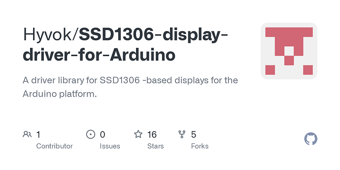

Looking at the 1306 driver on GitHub....
includes a 5x7 character set (LCD_font_5x7.h) which defines the bitmap for each ASCII character. You'll have to select an otherwise unused character and redefine this as a degree symbol.
e.g.
before...
	0x46, 0x28, 0x10, 0x08, 0x06, // y
	0x44, 0x64, 0x54, 0x4c, 0x44, // z
	0x00, 0x08, 0x77, 0x41, 0x00, // {
	0x00, 0x00, 0x7f, 0x00, 0x00, // |
	0x00, 0x41, 0x77, 0x08, 0x00, // }
	0x10, 0x08, 0x18, 0x10, 0x08  // ~
#endif
becomes...
	0x20, 0x50, 0x20, 0x00, 0x00  // ~   <-- redefine '~' to display a degree symbol
//    -#---    row = 2^6
//    #-#--    row = 2^5
//    -#---    row = 2^4
//    -----    row = 2^3
//    -----    row = 2^2
//    -----    row = 2^1
//    -----    row = 2^0
//    ||||+--- 0+0+0+0+0+0+0 = 0 (0x00)
//    |||+---- 0+0+0+0+0+0+0 = 0 (0x00)
//    ||+----- 0+0+0+0+0+2^5+0 = 2^5 = (0x20)
//    |+------ 0+0+0+0+2^4+0+2^6 = 2^4+2^6 = (0x50)
//    +------- 0+0+0+0+0+2^5 = 2^5 = (0x20)
#endif
(I'm guessing the pixel sequencing in the character array from examining the 'y' character. I could be wrong :)... but the above should give you an idea.
