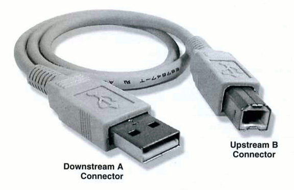

Do you need to do that? Couldn't you just plug into the USB(B) port of the Uno from the charger?
Sure, if the phone charger has a USB type B plug. Mine certainly don't.
Cool... I was thinking of this type of charger, then just a USB A-B cable.
Yes, just plug in a so called printer cable.
