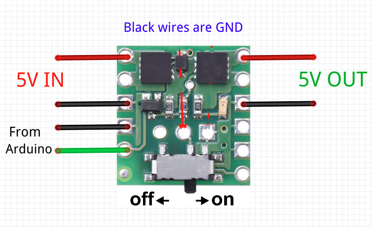

Use this module, controlled by the Arduino, to power the rcvr and have the Arduino turn it on after a delay of 2 seconds

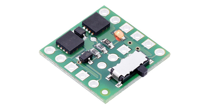

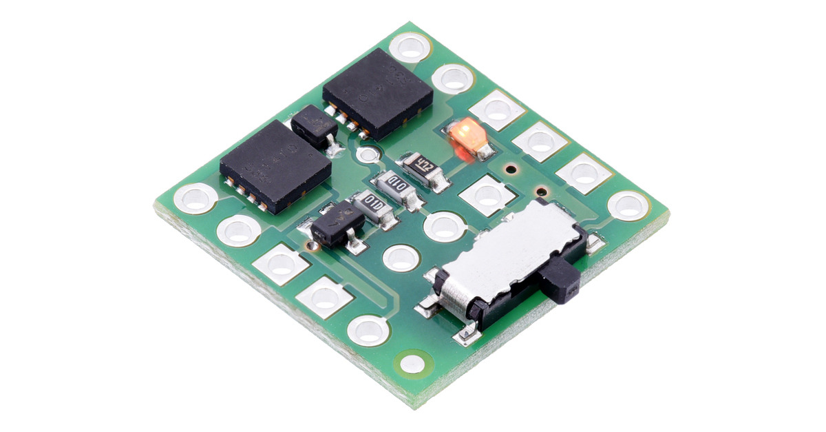

So use the pololu switch board, better than a relay.
Thanks Jim but I’m not sure how that would work - as I don’t have any other pins available?
