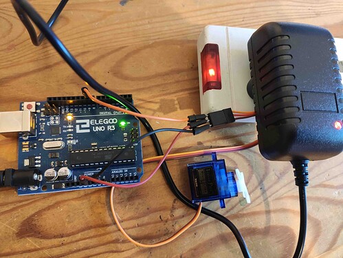

The summary line is: is this supposed to happen or did I break my Arduino Uno R3? I tried to power, a small DC motor from my Arduino as the book instructions show, it did not work, but my Arduino still supplies 5 V and 3.3V out, and the LEDs all work.
I am new to Arduino. I am learning it and teaching it to my nine year old son. I was lent a 'Arduino for Dummies' by a friend. Some friends gifted us, the Elego, Uno R3 kit. Both are excellent.
I read through the book, then started using the instructions in a book with the parts of the kit. I am using the snap image of the Arduino on the Ubuntu desktop. The examples in the arduino ide are excellent.
We worked through the LED fade sketche, button sketch, analog input sketch, and serial read and analog in and out sketch. We moved over to DC motors sketch. Following the instructions in the book, I drove a small 3 V DC motor from 5 V on the Arduino. This is demonstrated in the book (see page 148 on the link). I used an appropriate PN222 transistor, resistor and diode. The motor never really turned, but at times it would sing briefly, instead of turning. Since I could not get it to work I turned to the Elegoo website.
On the Elegoo website, there are comprehensive instructions (and very good too) on how to use the kit, I discovered the lesson (?26) on DC motors and that the motor in the kit requires a power driver. (you can see it in the top left of the image on the link beneath the CD). The Elegoo notes say if used without the power unit you may break the Arduino. So I may have broken the Arduino. I followed the instructions to set up the motor on a DC driver from the Elegoo instructions. The sketch comes from the Elegoo DC driver sketch. With the Elegoo DC driver and the chip suplied, this seems to spin the motor at high speed, medium speed (as the sketch instructs) but at low speed, it would not turn but did sing (from the power unit curiously). It the Motor broken? probably not if it turns. Is it just cheap? maybe.
Going back to the Arduino, I could get the 'broken' motor pin outs to work if I used an LED in place of the motor. This suggests the Arduino is not broken. Equally I could measure voltage across the 5 V outlet of the Arduino. I could also measure 3.3 V across the appropriate Arduino power out terminal. Answering the question is the Arduino broken? I am not convinced.
I moved on in the book to the servo chapter sketch. I connected at as is demonstrated in the book. I uploaded the ide example sketch as the book describes, but no movement, possibly a faint clicking sound. It is clearly trying to do something. I am wondering if this servo is also not able to be driven by the Arduino. However, it was part of the kit by Elegoo and Looking at the Elegoo docs it was wired as Elegoo suggest. Running the sketch makes the Arduino servo click but not move. Is this also just a cheap part? It looks much smaller and cheaper than servos I have seen before.
What do I conclude from this? The Arduino is trying to do something and it should work according to the book and the kit. It doesn't though, but it does do something. I cannot tell if it is broken or not. I am not sure where to go with this problem. The only thing I can imagine is to buy a new Uno R3 out right and test the servo on it. Is this what you do? Or do you have any better suggestions?

You may conclude that you are doing well. I assume that you have a multimeter ? that's very good :smiley:
Trouble with motors is what almost everyone encounters. It is a normal phase in the learning process. You are right on track :+1:
Background story about power usage:
A 9V battery is not good enough to power a motor and if you use 12V then you might destroy the Arduino board. A small servo motor might need a current peak of 500mA. The 5V pin of the Arduino board can not give that peak. A motor that is rated 1A might ask for a peak current of 10A. When the motor is larger then there are driver modules (or "drivers"). For strong motors, the driver is more expensive than the motor. A similar problem is with ledstrips. Put a ledstrip in your room and you might need a power supply of 20A.
The link to the book did not work for me, this works: https://archive.org/details/pdfy--LpbPxUly33g2cjN
That circuit on page 128 (the 148th page) is okay, although the 5V pin is probably not strong enough for a motor.
Can you show a photo with the power supply and all the wires ? We can help to make a circuit for the motor. Start with the servo motor, that is easier. Do you have a 5V power supply ?

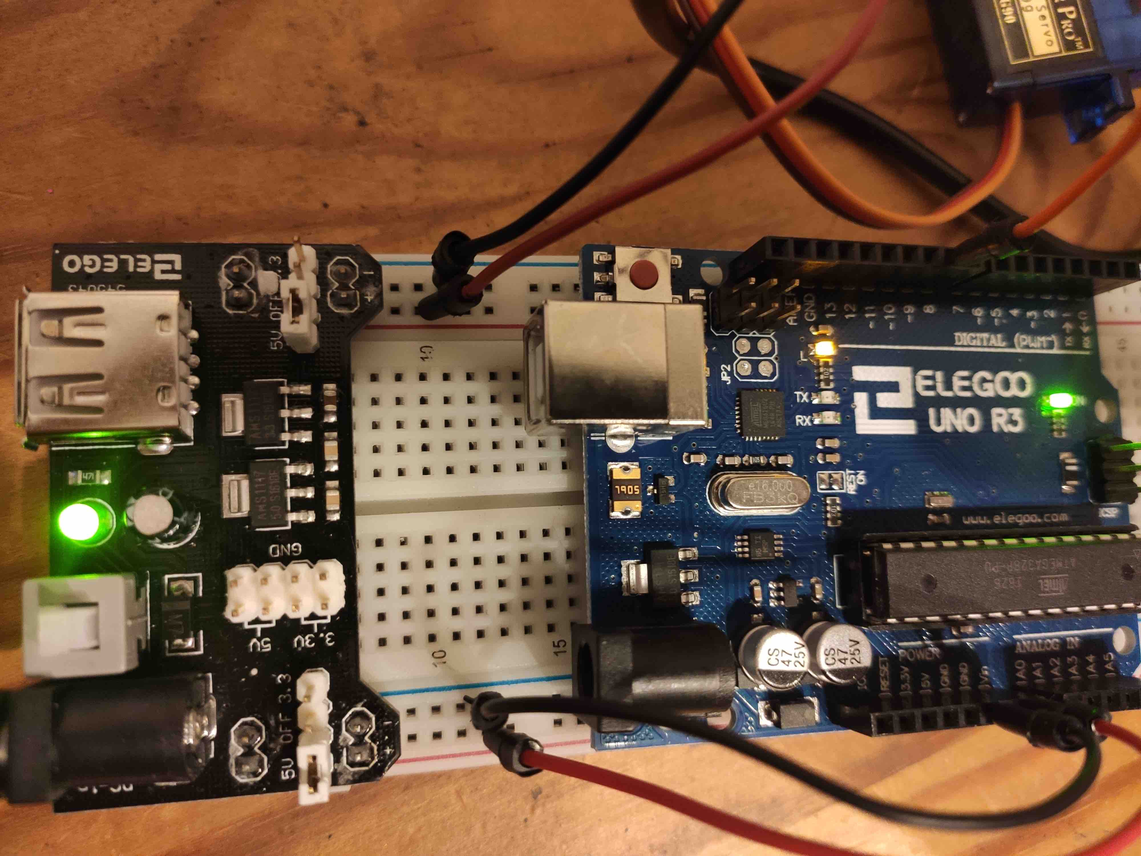

Okay, so good news. Starting from scratch and plugging together as per the instructions on this link under the servo chapter. It works here is a photo of it.
You asked about the power supply, I checked. It is a wall socket 9V DC 1A adaptor. Using the Elegoo sketch, I can turn to a defined angle. Using the Arduino IDE sketch I can do a gradual sweep. It was doing this when I took the photo.
I think this is all-round success. It demonstrates both the (cheap?) Servo is functional and the Arduino is functional on the pins shown (5v, GND and PWM on pin 9). Next step is the DC motor.
See the next post.
We are all frowning and making faces behind our computer :grimacing:
The voltage regulator on the Uno board has to dissipate the heat from 9V -> 5V and the 5V pin is not good enough to power a servo motor. A good solution would be a 5V adapter to power the servo motor. It is possible to power the Arduino board also with 5V, for example via the USB connector.
Noted. I have a voltage regulator which can supply 5 and 3.3 volts. I thought this was for the motor only.
No damage yet, still works.
If I disconnect the power and leave it on usb it still functions, so usb supply is good enough.
The supply has 2 rails of independent supply. I can set one to 3.3v and one to 5.0v.
I hope the frowns have gone now.
Both rails were on 5.0v. The R3 had one and the servo had the other. It was doing the servo sweep in this sketch. No 'hot' or 'smokey' smells. The 'sweep' code is somewhat step-wise.

Servo work well with the sweep and position sketches, if:
  1. using power module (5V) to supply the servo
  2. using power module (5V) on other bank to power uno
  3. signal from uno to servo
    Thankyou problem solved. Son inspired: 'can we make robots now?'

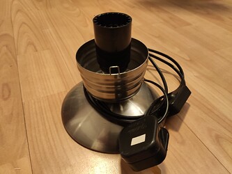

The crafting project: see the photo. I have a lamp base the design of which is (was) a large light bulb. A family member broke the original glass. In effort to replace it, I think I want a horizontally rotating plate to aid in crafting a plastic replacement. (I have the plate I just need a low force/speed driver). Once replaced, it would be an arduino classic to have some interesting/attractive/decorative arrangement it there. I was thinking of a mock filament, coded to flicker as it might have done in Edison's day. But one thing at a time, I will probably just use a normal bulb for now.
I am thinking I can manage finding some LEDs (problem 3), there are good options, thanks for the suggestions. The motor issue is resolved for now (problem 1). The LCD issue is off topic for a motor problem so I started a new thread. I will post a photo over there shortly.
