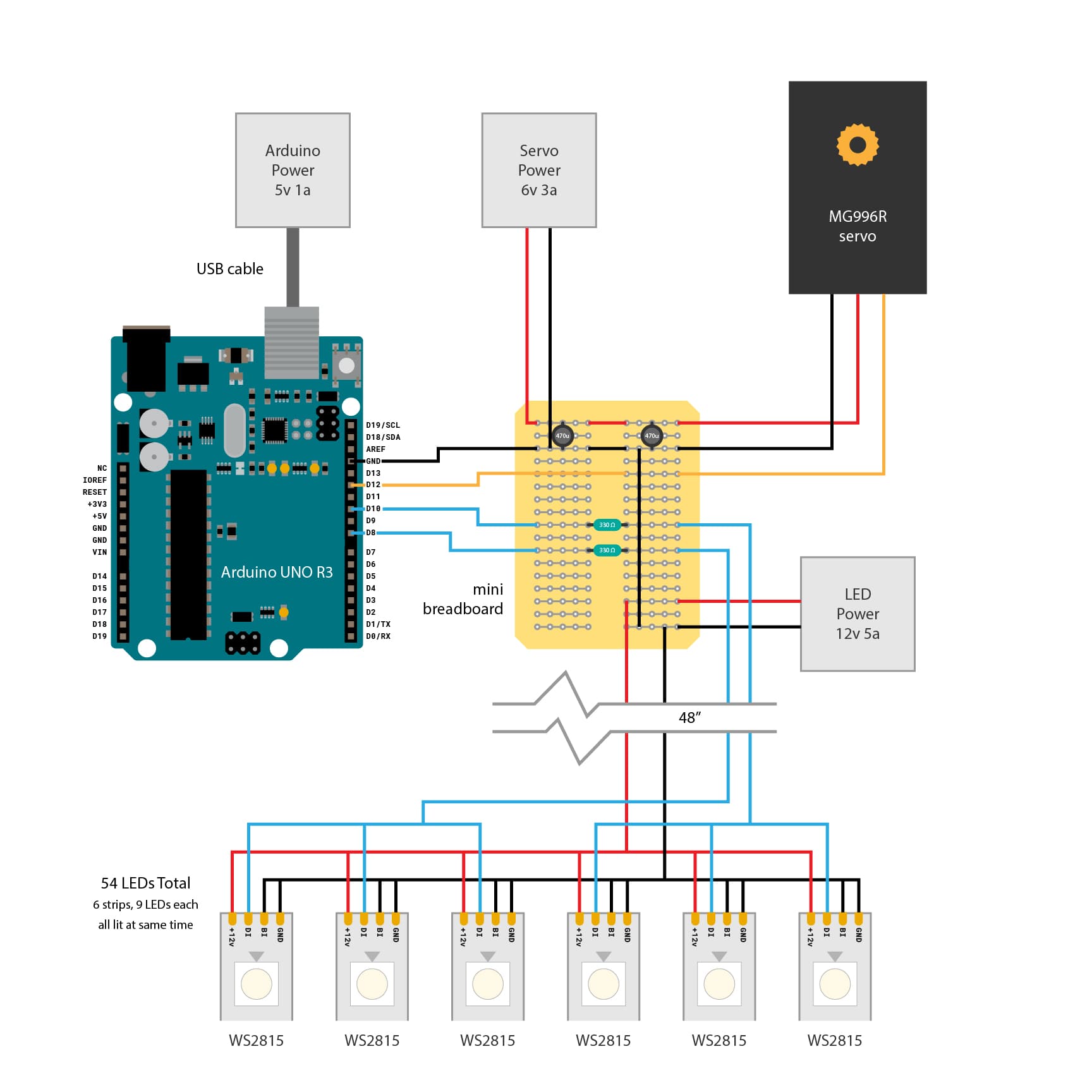

Did I get this schematic right? Uno R3 + MG996R servo + WS2815
Hello all, I'm a newb to electronics, and this is my first time posting.
I'm using an Uno R3 to run a MG996R servo, and a cluster of 6 short WS2815 strips in parallel, of 9 LEDs each, and all LEDs will be on at the same time. Each of these components will be powered by its own separate power source.
I also have a mini breadboard for mounting pieces, and being able to make secure wire connections and have a common ground.
I was a little overwhelmed reading through so much information and differing opinions about adding resistors or capacitors, so I wanted to double check that I got things right. I have two 470uf capacitors on the servo power, and a 330 ohm resistor on the data line running to the parallel WS2815 strips.
Do I need any additional components? In line fuses anywhere? Thanks!
  • All 6 strips are in parallel, you might need a driver if things don’t work as expected.
  • Good work on your wiring diagram.
Apart from the wiring of the WS2815. You don't actually wire them like this. They are a strip, with two data inputs, and all the rest is chained.
See this
Also I hope that none of these external power sources are batteries. If so you will run into trouble.
It should certainly be possible to run strips in parallel as well, as long as you wanted them to always display the same colors/patterns. Less overhead for the Uno. Like LarryD, I don't know if an AVR adta output is quite up to driving 6 parallel strips.
The WS2815s are on a chained strip, but I'm going to have 6 parallel strips of 9 LED's each... I know it's weird, but these short strips will be arranged around an object like a bulb. So there will only be 54 LEDs lit at once, so hopefully not enough power draw to require a driver?
And no batteries, they'll all be connected to 110v and converted to the output shown.

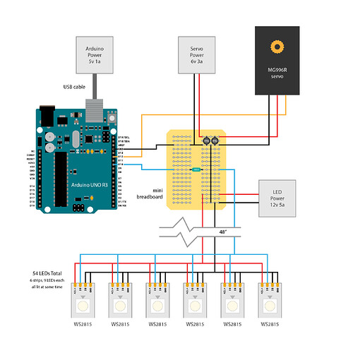

It's not "power draw" that is a concern here (you already have a nice separate power supply for the LEDs.)
It's the integrity of the data SIGNAL value as load (capacitance and resistance) is added.
Ahh, that's super helpful. I could split the strip array into two parts, and have 3 on one data pin, and 3 on another data pin, and just have the program output the same signal to both of them, like this?
No.
This is because after each LED in the strip the signal is regenerated, so the main problem with signal integrate will be from the output to your chip.
Use a series resistor of 200 to 450Ω along with a large capacitor, like 100uF or bigger between power and ground at both ends of the strip.

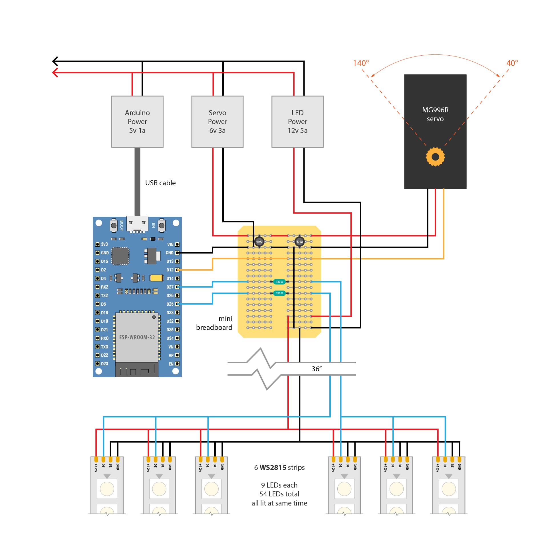

Hello! I'm trying to use a ESP-WROOM-32 to control a MG996R servo and two clusters of WS2815 strips, but I'm running into problems. The servo should sweep slowly from 40° to 140°, but it's very jerky and has large unexpected movements, and the LEDs aren't lighting up. The servo works relatively smoothly when I use the FastLED library, but goes bonkers when I use the NeoPixel library.
I've successfully made LED strip clusters like this before with an ESP32, but I was using WS2812s and not WS2815s, and used FastLED instead of NeoPixel too. I think I need to add a logic level shifter like a TXS0108E to bump the data signal from 3.3v to 5v, right? Or is there a simpler method that wouldn't invert the logic?
Here's my wiring diagram and all the code, which ChatGPT helped me with, which is likely part of the problem too. I'd love any feedback on how I can improve this!

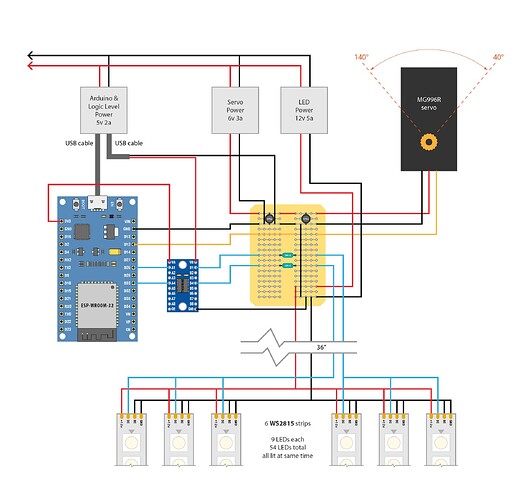

So if I add the TXS0108E logic level converter, I think I add it to the system like this? I want to have the ESP32 powered by its own USB cable so that i don't accidentally fry it when I do code updates, so I'll get a USB wall wart with 2 slots and output one to the ESP32 and one to the converter.
possibly a problem with Migration from ESP32 Arduino Core 2.x to 3.x
I have had problems with the Adafruit_NeoPixel library when using more than 85 LEDs
maybe worth trying ESP32 core 2.0.17
