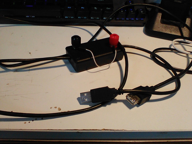

Get yourself a USB cable.
Cut the cable in half.
Reconnect ALL the wires in the cable EXCEPT the RED wire which should be +5V
Now you have a powerless USB cable to communicate and program an external powered Arduino controller.
This is mine, the terminals on the top are connected to the two disconnected ends, so I can still make it a power through and/or insert an Ammeter to measure current.
Tom... :slight_smile:
Not relevant to a Nano. other than to measure current. :astonished:
