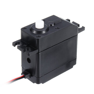

Will I be able to power bigger servos via Nano connected to the USB?
With bigger servo I mean this one:
Thanks in advance!
No.
The Nano has a backflow protection diode between USB and the 5volt pin.
You will fry that schottky diode if you try to draw more than 500mA from the Nano's 5volt 4.6volt rail.

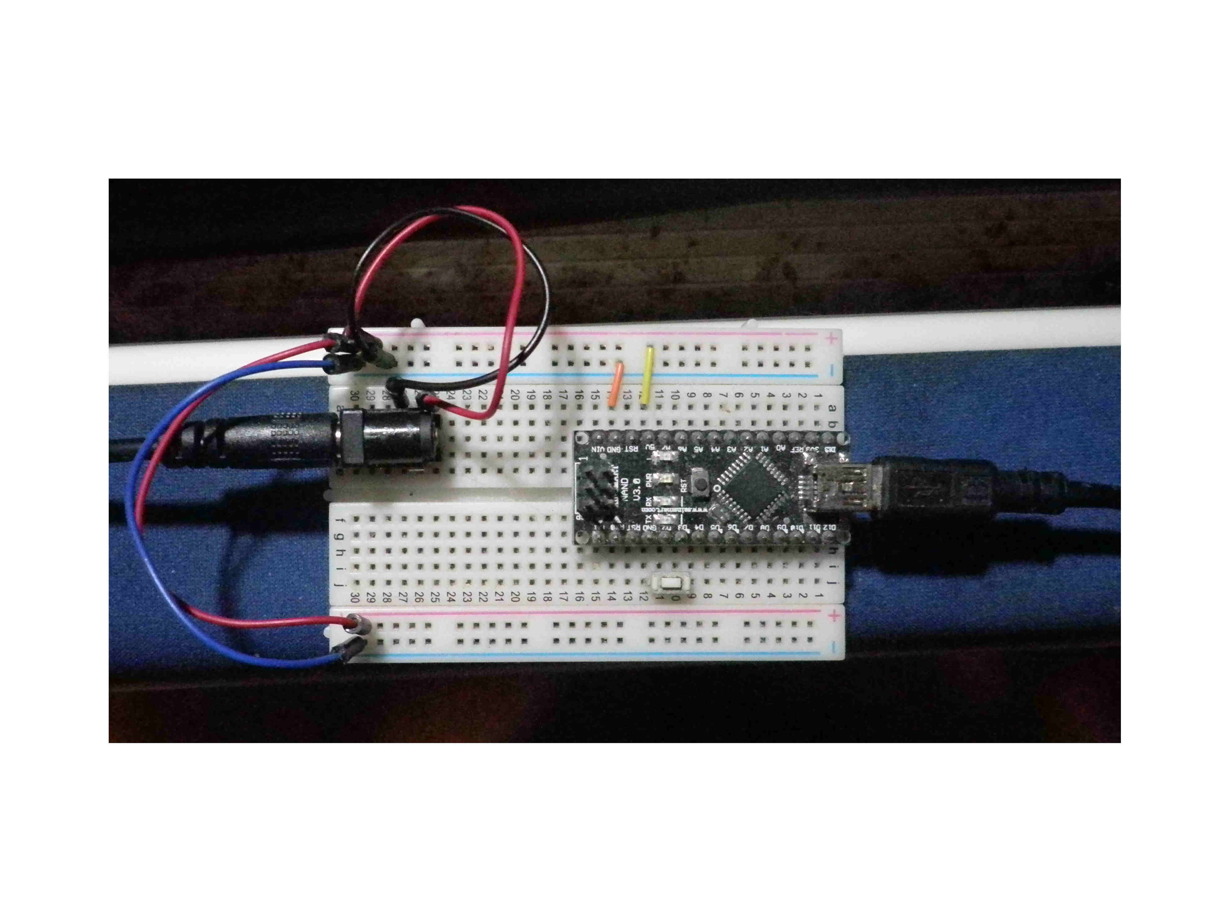

I think you asked if you could power the Nano through the USB socket (with the USB supply and a USB cable).
And power the servo from the 5volt pin of the Nano.
That is not possible.
Leo..
If you don't need USB communication, take a USB power cable like the one I linked, cut the barrel connector off, connect the + wire to breadboard + bus, - wire to - bus put a jumper from + bus to Nano 5V pin and a jumper from - bus to Nano GND pin, you can still plug in the USB cable from the computer to communicate but you may get a reset.
Make sure the 5V supply is well regulated.

I have ordered this breadboard to have smaler projectboxes:
outsider:
Or keep the barrel connector and use one of these:
Search Results for barrel connector - SparkFun Electronics
Thanks for the tips.
But I find that to be alot of "more work" for nothing.
Fewer connections = lesser chance for problem. (I work as a automation electrician on a big maintenance department).
One rail for powering the nano and the Servos +5VDC -IF IT´S POSSIBLE?

About this Amp draw I "googeld" the two servos I will use.
The first one: (I think It will never use more than 500mA, so I will use it from USB power).
The Second one I´m a bit worried about.
According to these charts It draw 1.8 A with one controller, the rest under 500mA. Now what? :slight_smile:
