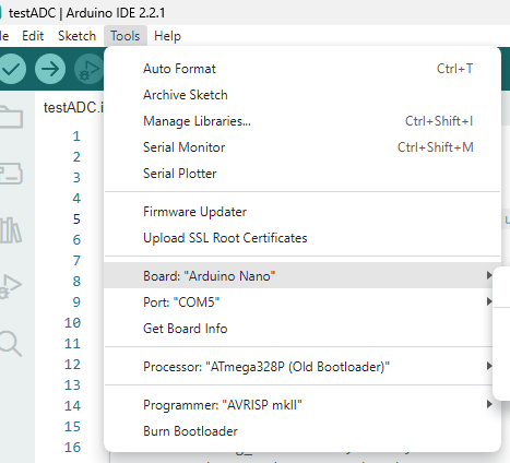

When you launch the ide it shows the previous settings. I have an ESP32 devkit connected to my USB but this is what I see
when I select the correct port
Then you need to select the correct board - in my case ESP32 Dev module.
As a beginner you will need to look at the specs to see which best fits your needs
If you examine the devices connected to your USB with UsbTreeView (Indispensible for resolving connection issues)
you will see that it identifies the unit connected to that USB port - which is just the USB/TTL bridge, eg
Silicon Labs CP210x USB to UART Bridge
so beyond that the computer doesnt know what its connected to.
