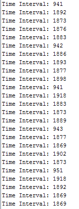

I wanted to know how much time (in microseconds) it takes for a sensor to output data during each scan. I used the following code to print the output of 3-axis accelerometer:
// IMU 1 sensor - I2C //
//Acceleration Data (gravity + linear motion)
  unsigned long startTime = micros();
  imu::Vector<3> accel1 = bno1.getVector(Adafruit_BNO055::VECTOR_ACCELEROMETER);
  imu1_data[0] = accel1.x();
  imu1_data[1] = accel1.y();
  imu1_data[2] = accel1.z();
  unsigned long endTime = micros();
  unsigned long elapsedTime = endTime - startTime;
  Serial.print("Time Interval: ");
  Serial.println(elapsedTime);
The data for each axis is stored into an array called "imu1_data" assigned with a float variable type. I used the micros() function to keep track of the time it takes for that section of code to execute, but the time interval keeps changing (as shown in the attached picture). I was expecting the time interval to be relatively constant for each data scan, and this was the case when I tried using the micros() method to track the time interval for time-of-flight sensor data scan (assigned a uint16_t variable type). However, the time-of-flight data used a for loop to retrieve the data (shown in the code below) instead of storing the values in an array, but I'm not sure if that makes a difference as to why the time interval keeps changing.
The answer to your question is neither.
The data appears quite predicable within the limited sample you posted. Something is using double the processor cycles for about 7-8 milliseconds then it drops in half for a millisecond. It’s no doubt elsewhere in your mystery program.
Next time, please copy the output from the serial console and post into a code window, far more user friendly, especially for mobile users.
OP’s image:
That is weird. A full millisecond extra delay.
This is the getVector: Adafruit_BNO055/Adafruit_BNO055.cpp at master · adafruit/Adafruit_BNO055 · GitHub.
It calls readLen().
That is all very straightforward, nothing special.
The BNO055 is not a dumb sensor that returns data, it has a processor that returns data when it is in the mood to return data.
If there are no mystery interrupt routines, then I assume it is the BNO055.
Do you have a logic analyzer ? Then you could measure the I2C bus to check if the BNO055 holds the I2C for 1ms.
Unfortunately I don't have a logic analyzer. I was wondering if it had something to do with the nature of IMUs in general and how it retrieves the data? I first thought it might have to do with the way that I wrote the code, so I tried doing it 2 different ways, the first way is how they show it on the Adafruit website:

But both codes seem to have inconsistent elapsed times between each sensor scan, as shown below:

As I wrote before, the BNO055 is not a dumb sensor that returns data, it has a processor. So you have to look inside the processor of the BNO055 to see what the cause is. Or measure what it is doing on the I2C bus. Or accept that it seems to be busy sometimes and needs more time.
This is not because it is a IMU, it is about the processor inside the BNO055.
