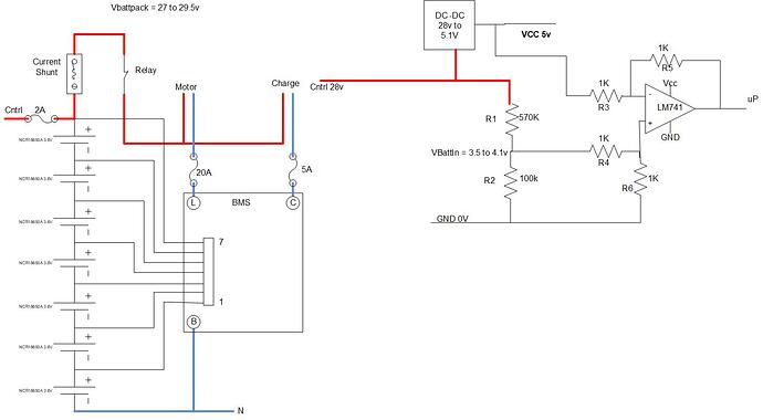

I need help with Diff Amp Cct (see attached image). Im a bit rusty with my electronics but ive jumped back into the deep end.
Im building a Energy Management System for a Lithium battery pack. Im using an off the self BMS.
The battery pack will swing between 27v and 29.5v. I have voltage divided (VbattIn) down to swing of 3.5V to 4.1v. I have DC-DC down to 5v (Vcc) for the control circuits.
I want to compare Vcc to VbattIn (which should be 0v - 1v max ). Problem is when connect R6 to GND it shorts out via the 2k path to GND. My guess ts the selection of the 1k resistors around the Op Amp.
Any feedback / comments or suggestions would greatly help.

Get an ADS1115, and divide the pack down to 4.096volt (PGA1) or 2.048volt (PGA2).
High enough resolution for the voltage window,
and build-in internal reference (not the potentially unstable 5volt supply).

Firstly a voltage divider must never be loaded - so you'd need a buffer after the divider to drive a diff-amp circuit.
However that's completely unneeded because the gain/attenuation of a diff-amp circuit is completely adjustable
by the resistor ratios. It can do the division by attenuation itself.
You have chosen a unity gain diff. amp circuit, that's a special case. You have chosen 1k resistors in
your diff. amp circuit, which is pretty low for an opamp circuit - the '741 can't actually drive 1k, it's
good only for loads of 2k or more. 10k is a much more common value to see in opamp circuits unless
low-noise is an overriding issue.
If you are trying to compare voltages, use a comparator, not an opamp.
µA741's are pretty hopeless by modern standards, and here I think you need a fully rail-to-rail opamp anyway -
or a comparator perhaps...

The diff amp equation is basically V2-V1.
You have your batt voltage connected to V2 instead of V1.
Your 5V is >than your batt input so obviously V2-V1 will be <0 | Where V1 >V2
