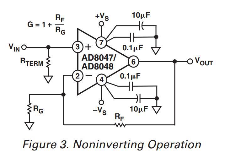

I must Convertia signals voltage range from 0-4.8 mV to 0-5 V.
I have a LM741 OpAmp.
Can i use it?
how?
Thanks

Yup, you can use that op amp.
(you can ignore Rz)
The gain is determined by A=1+Rf/Rin. So to amplify the signal by 10 times, you would need Rf/Rin = 9.
So could use a Rf = 10k, and Rin = 1.2k, and that would get you a gain of 9.333, which is pretty close.

First, you are asking for an amplification of about 1000 (0 - 0.0048 => 0 - 4.8 V) which really requires at least two stages of amplification to be stable (IMO). Second the 741 can not approach its power rails, so in order to achieve a range of 0-4.8V the power rails have to be both below 0V (negative) and above 5V... If you don't already have such power rails available, it would be better to choose another opamp with rail to rail capability.
Insert my schema.
I use 0 and 5V.

Then as I said the 741 WILL NOT produce the output range you want. Select another opamp
Can you suggest an opAmp?
There is a two stages in a single chip?

There are what are known as dual or quad op-amps which have either two or four opamps per IC.
One rail to rail that should work is the TI LMV358 (dual) or the TI LMV324 (quad). Personally I would go with the quad and have three stages each with an amplification of 10... (using the values mentioned above).
In general the higher the amplification one attempts in a single stage, the more likely problems will be encountered--about a 100 amplification per stage is a good max for rule of thumb

If i use TI LMV358 (dual) with 35 of amplification for each stage -> 35*36 = 1260 that is what i need.
what do you think?

Not quite; first consider that available components (resistors) and their tolerances will affect the actual gain versus the theoretical gain. And again, your math is off, you do not want a gain of 1260... which would take a signal of 4.8mV (0.0048) and produce an output of 6.048V... Actually what would happen is that since your positive supply is only 5V, any signal over (5V/1260) or about 3.97mV would produce a 5V output... This is called clipping... You need a gain of approximately 1000 for your sensor...
So for a two stage amp you want a gain of approximately 32 for each stage.
