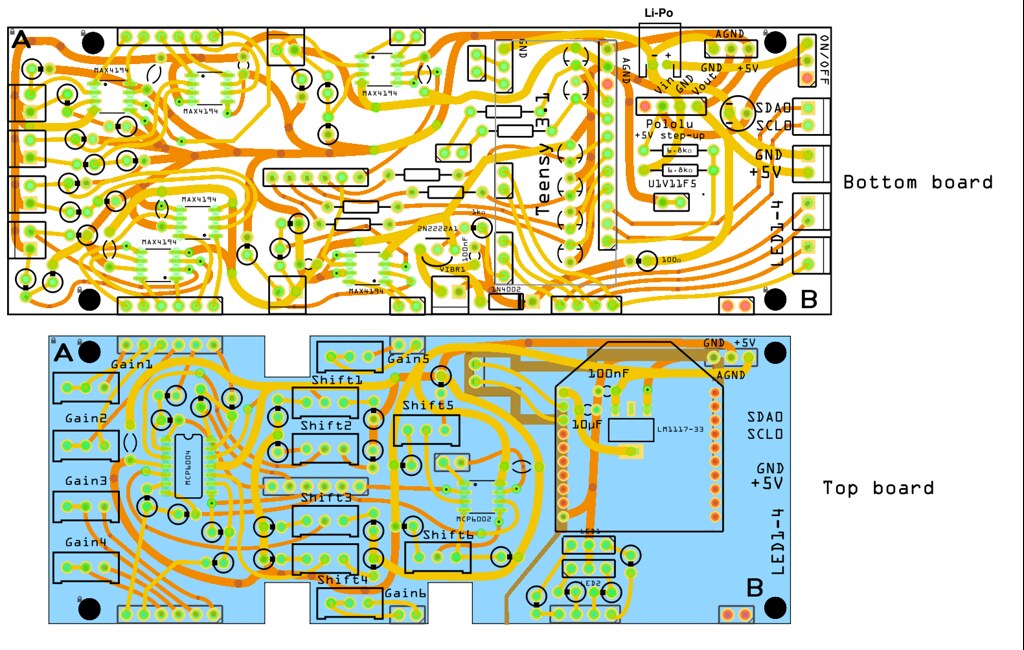

I have two boards connected, both with analog and digital parts, each part having a different ground plane.
My question: should I tie analog and digital grounds from one board before connecting it to the other board or should I have different GND and AGND connections between the boards ?
Thank you in advance.

Here's the current PCB layout.
There are two boards interconnected on several places. The idea is to have two boards to reduce the footprint (major requirement). The top layer contains many trim pots, op-amps, an XBee board and LEDs. The bottom layer contains connections to analog sensors (left, top left, bottom left), instrumentation op-amps, the microcontroller (Teensy 3.1), as well as a connection to a LiPo cell (top right) and a +5V step-up voltage regulator. There are connections to a future secondary circuit (right) as well as a circuit to power and control a vibrating motor (bottom center). Bottom and top boards are interconnected at several places with pin headers. They connect top trim pots to adjust gain of the bottom instrumentation op-amps as well as the output of those op-amps to the top layer where additional analog treatment is done. Then the analog signals go back to the bottom layer and the microcontroller. The pin headers also carry serial signals to the XBee on the top board.
Brown zones in the top board are copper fill blockers from Fritzing, meant to separate analog and digital ground planes on the top board (to be added later). Similar work should be done on the lower board too.
The top right header connects both GND and AGND (as well as the +5V) from bottom board to top board.
Second picture displays where circuit's analog (blue) and digital (red) sections are (click on pictures to have them in higher resolution).
So, as the top board is more like an extension of the bottom one, should I really merge AGND and GND together on the top board?
Well, I think the fact that there is a question indicates that there is a flaw in the design. If instrumentation amplifiers need to be trimmed, then those signals should all be contained within one PCB. You shouldn't have the low-voltage external signals crossing boards.
Now if you had all the delicate inputs and trimpots on one board and then the amplified signals go off to another board for further volume/tone controls, then perhaps that's an acceptable solution. Then the noise from digital ground should be negligible compared to your analog signals.
Since it seems like this design is "close enough" then perhaps it's acceptable to have analog ground at one end of the two PCB's, like you're making a Faraday cage for your analog section. If that's the case, then you probably shouldn't have power and digital ground on the same header. Either way, I don't see your proposed solution as being wrong or naieve.
