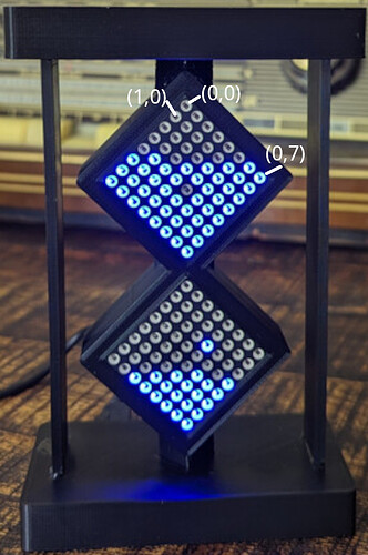

you mean something like that?
(In german, but with an image attached)
I can give you the code if you like. But it does not look very realistic :sweat_smile:
Hey,
Yes this is exactly what we are trying to do.
We got some example code but they did use other components and the code somehow does not work then so we tryed to do it ourselves.
But as I said we got problems with the led going down the right path and stuff.
But if u could sent usbur could this might help so we can check how u did solve this.

Here is how I would write a formula...
(line 1 has 1 LED)
  • LED #1 location in each square is 0,0
(line 2 has 2 LEDs)
  • LED 2 = 1, 0
  • LED 3 = 0, 1
(line 3 has 3 LEDs)
  • LED 4 = 2, 0
  • LED 5 = 1,1
  • LED 6 = 0, 2
(line 4)
  • 7 = 3, 0
  • 8 = 2, 1
  • 9 = 1, 2
  • 10 = 0, 3
See the pattern?
  • Next line number (L) increases by 1 (toward a MAX of 7)
  • First LED in line number is (L-1, 0)
  • Next LEDs - "x" decreases toward 0, "y" increases to L-1
  • Last LED in line number is (0, L-1)
  • After you get midway (7,0) (1, 6) (2, 5) (3, 4) (4, 3) (5, 2) ( (6, 1) (0,7)... decrease the number of "x,y" pairs
  • (line 14 has 2 LEDs (7, 6)(6, 7)
  • (line 15 has 1 LED (7,7)
Each time you set "x, y" to OFF on the top square, you set "x, y" ON on the bottom square.
Give it a try...

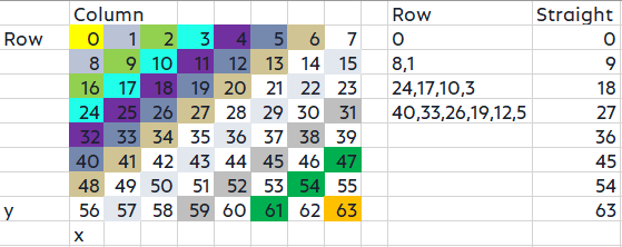

Additionally to the great explaination above, it helped me to draw the matrix in Excel:
grafik
And here is my (not cleaned up) code:
