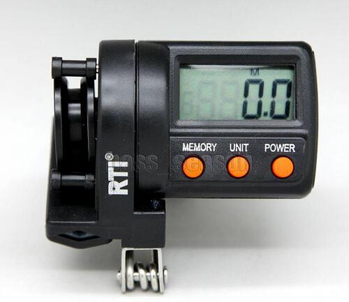

If not, would it be possible to connect the below counter to the Arduino and control it by the Arduino?
For example controlling the line length by programming the Arduino to control a motor as a spool and makes it stop or move when the counter reading reaches a specific length ?

But doesn't the digital fishing line counter above use the same principle?
I am thinking that it might have a built-in encoder either an optical or a mechanical one !
I couldn't find the technical specs and parts for it online.
But lets say it is true, would it be possible to wire it to the Arduino and program it to do the job ?
