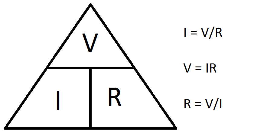

You can connect your meter from Vcc to ground to measure voltage. Connecting the meter in the same way to measure current will result in a dead short. If your meter is so equiped, the fuse in the meter will blow, otherwise expect smoke.
Using the
you can measure the voltage and the current to get resistance.
