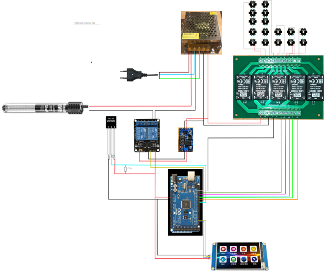

I'am making a automated system for my aquarium and a part of this system is adjusting the brightness of the lights and making it possible to dim completely. I am using 5 meanwell ldd drivers on a PCB board which require a PWM value from 0-255 each.
Ive tested the dimming with a potmeter and mapped the value from 1023 to 255 and wrote it to the PWM output pin for the driver using analogwrite and that worked!
Now I made a Nextion file with sliders to send the PWM value to the drivers but there is a problem. The lighting is not dimming its just going on at a value of around 134 with full brightness and of when the slider is below that. Ive checked the values the slider puts out and those are values from 0-255 just like I want. Its just not working...

I use Meanwell LDD-1000H so just PWM will do I think, thats why I dont understand why its not dimming. It looks like its just a low or a high for on or off. However I don't understand why...
What CPU or board you use. 3.3V should be enough.
Have you checked your LED controllers datasheet that your PWM frequency and so on is good.
Try a single led (and a resistor) connected to your CPU, if it fades then your sketch is OK.

I am using an Uno and the voltage should be just fine. The voltage to the drivers is provided externally the only thing needed for dimming is a PWM signal. Here is a schematic (only with a mega which I made.
Found it!, pin 8 on the uno is not a PWM pin.....oops
