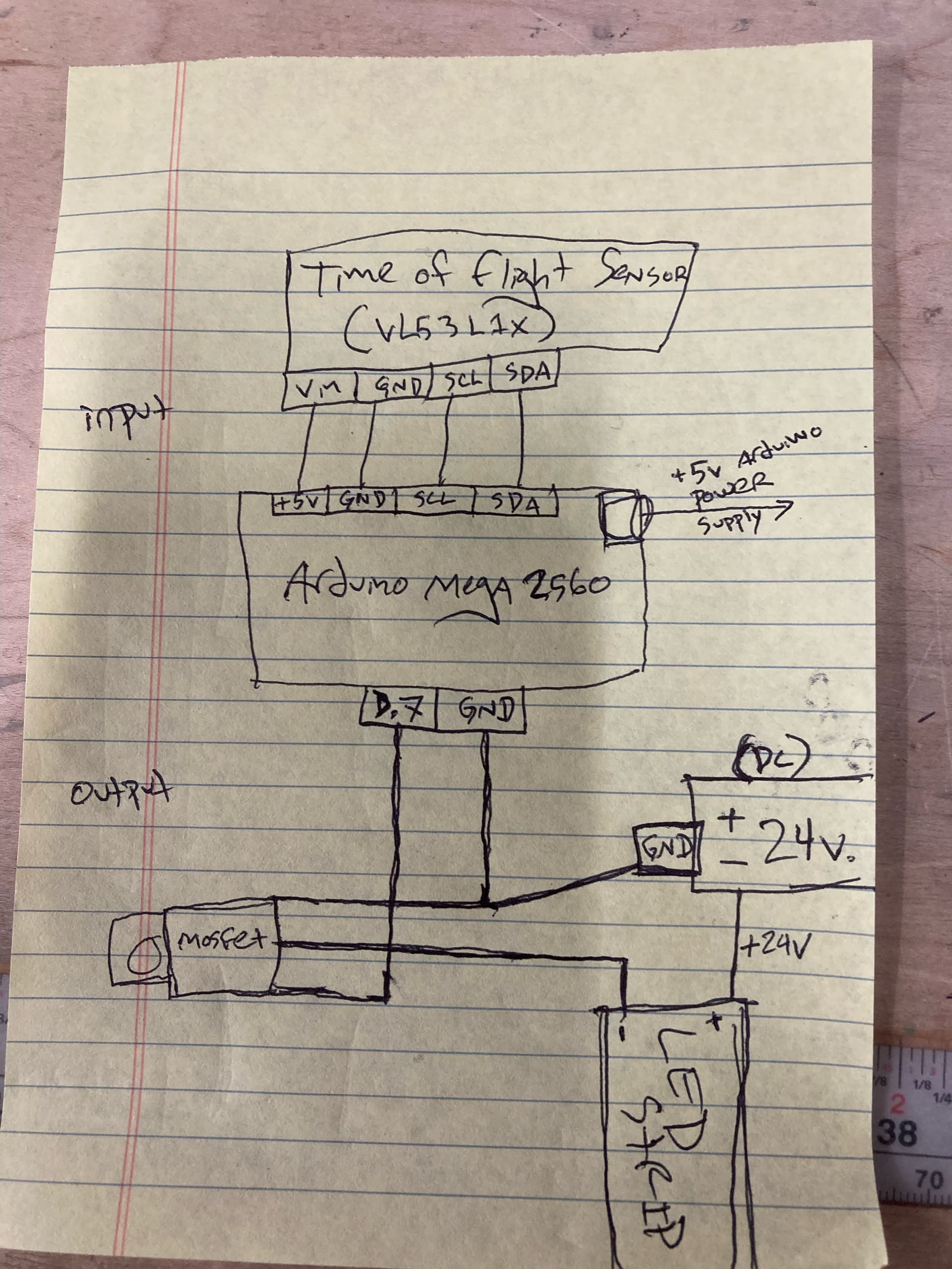

@PaulRB this is all true, I actually did want my arduino to do nothing and not check for anything else while on delay(), but maybe this is clogging something? Also, I had to run some long wires between the sensor, arduino (mega) and mosfet in order to place things in my setup appropriately, and after a few successful runs, the lights do not turn on anymore and the serial monitor stops communicating. After testing, what I have discovered is that after a power cycle the system works as expected for a couple more iterations, then stops again. Sometimes I have to reset everything. Very inconsistent function. Why? And how do I fix this?
This sounds like a hardware problem. Post your schematic and some close-up, clear, bright photos of the circuit so that every wire can be traced.

I can't see anything obviously wrong with the code or the circuit.
What model of MOSFET is that? Is it logic-level?
If you connect the PSU directly to the led strip and leave it for a good length of time, is there any flickering or dimming?
If you add the MOSFET into the circuit and connect it's gate to 5V instead of the digital pin and leave that for a good length of time, what happens?
Hey @PaulRB,
It is a logic level mosfet!
The leds do not flicker when directly connected to the power supply unit.
When I wire the mosfet directly into 5v the leds stay on with no flickering.
When wired correctly, the leds eventually just do not turn on at all and the system becomes unresponsive.
Any ideas? I am about to try replacing all wires with grounded, shielded wire.
Probably won’t change things, if this is an N channel MOSFET, a 10k resistor from gate to GND is recommended.
Similar to circuit F2
There was some guy on the forum only a couple of days ago saying he had a logic level MOSFET, but when he revealed the model number, guess what?
But if connecting the MOSFET gate to 5V causes no flickering or other problems then I guess you are right.
Those tests point back to a problem with the sketch, I think, not the PSU, MOSFET or wiring. What does serial monitor show just before the problems begin?

Double checked the mosfet, that seemed solid! Moving to shielded wire helped a lot, also that return removal helped a lot as well, seems to be running smoothly now! Thanks
