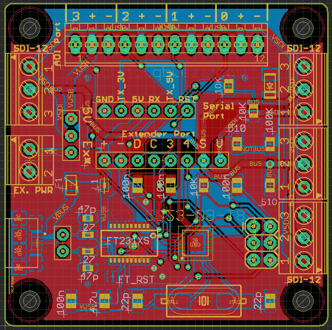

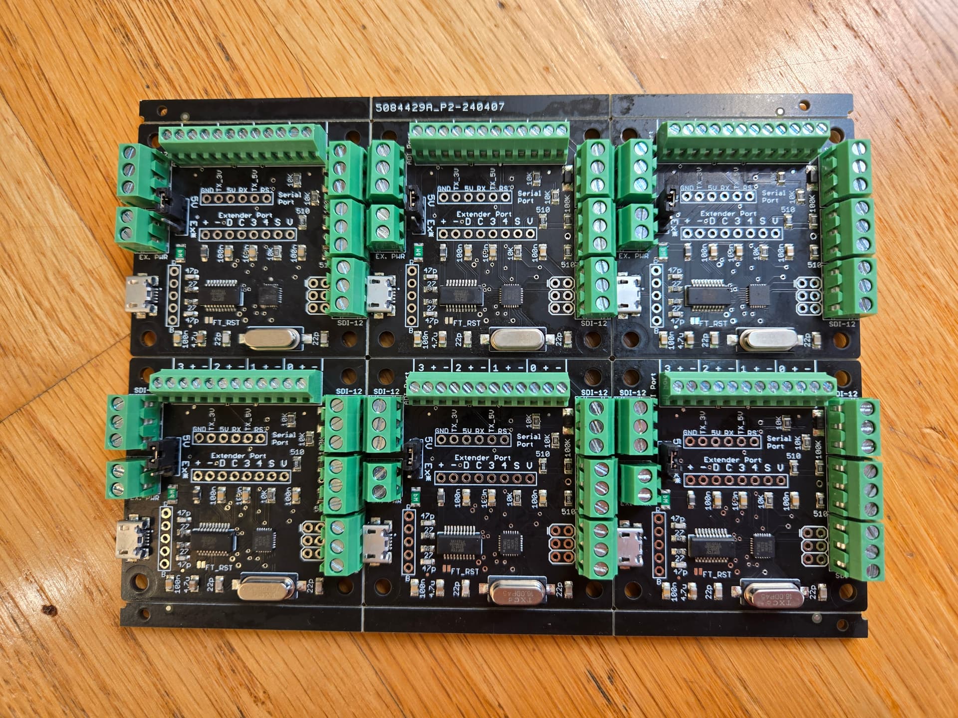

It's a 2" by 2" (5cm by 5cm) board on a 3-col*2row panel, with 29 thru hole pins per board. So the whole panel has 174 junctions. I hand solder fast, almost 13 junctions per minute. If I have 12 panels, that's 2,088 junctions or 164 minutes of hand soldering. If I dip solder, it takes about 15 minutes of spraying, dipping, and cooling. BUT, there is time for solder blobs and Kapton tape and one part I must hand solder. So altogether, I am twice as fast with dip solder, only if I manage to exceed 174 junctions per dipping, with at least a dozen or more panels, and only if I don't count parts prep time, just the non-part-prepping time. Parts prep time such as time to insert parts, use putty to hold some parts etc. is similar between dip soldering and hand soldering. Under these assumptions, I saved about an hour :roll_eyes:
The contract board has one board per panel (two actually but I must break them apart to fit my solder bath). This board has 57 junctions. So doing 57 junctions per dipping is probably not as advantageous as my own board with 174 junctions per dipping even if I need 200 boards vs my own 12+ panels, especially considering the possibility of failures.

Now I order panelized boards that fit on my pnp and not too big for my stencil printer, and fit inside my reflow oven without wasting space. This panel is the 3rd generation since I have started with this setup. The solder bath size becomes a 4th limiting factor of the panel size. I can make a couple hundred devices in one go now, still tiring but about 8-16 fold improvement in SMD parts throughput. Dip soldering helps this project because it has lots of pins. I just need to perfect it so I don't have to waste time removing solder blobs. Dipping the panel in flux will be what I have in mind next time vs vertically spraying upwards against the underside of the board.
I do SMD components first, flash firmware and test, hopefully in the summer when my garage is warm/hot instead of the freezing winter. After I have a stock of these panels, I can take time later in the season to do the thru hole parts in small batches when I receive orders.
