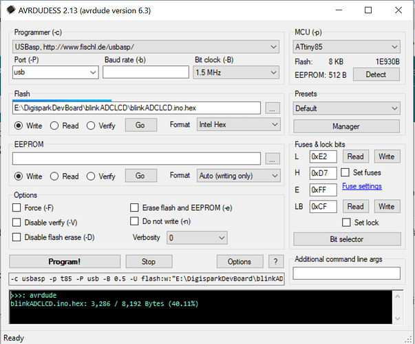

I use the following GUI Interface (Fig-1) and the AVR Programmer (Fig-2) to perform read write operations with EEPROM Memory of AVR MCUs without disturbing the content of the Falsh Memory.
Figure-1:
