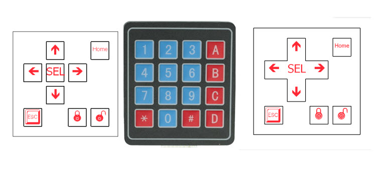

I'm looking for a simple 5 input keypad, with 4 directional arrows and a select button in the middle. In a perfect world I would like it to be backlit and made of silicon, but given that I can't find anything even remotely close as of now, any material is fine. These things are everywhere on appliances and electronics, there's gotta be some place that sells them. Anyone have any input?

Use small push button switches that can be found at sites like Sparkfun.
Make up the matrix up on a PCB and place an overlay over the switches.
See the attached image on the right hand side of a sample that I made.

Sorry for misunderstanding you then. But yeah, I understand the process of making a matrix keypad. Is that what that picture is displaying? Forgive my ignorance, I'm not entirely sure what I'm looking at. I don't know if this would be considered a matrix since I wouldn't have two wires running to each button, but I was thinking I could reduce it to 3 inputs with some OR gates, giving me a max of 7 push buttons (binary 001 - 111). But that really isn't the problem. I just need a source for a keypad like I described or a button that gives some kind of directional indication to a person who isn't familiar with the device.

I have also used:
HERE.
You can either use them in a matrix or wire them to inputs directly.
The attached image is also a good choice.
HERE
They are high enough that surface mount LEDs can be placed by the side of the switches which might give you the back-light that you were talking about.
The LEDs will shine through the laminated overlay.
Then you can make a laminated overlay to cover the switches like I did here in the 2nd image.
Your example?
Yes, exactly like that. How do the buttons feel quality wise? And where do you have your laminated overlays printed? I'm assuming you use some type of service to have that done.
The switches have tactile feedback.
IMO they are good quality.
I use SketchUp for designing the overlay but any graphics program would do.
You can go to Staples and they will do laminating for you for a few dollars.
I suggest you use their thinner lamination as their thicker one is quite stiff.
I use this machine for laminating but it is expensive.
http://www.staples.ca/en/3M-LS950-Cool-Laminator/product_41407_2-CA_1_20001
I have also taken an existing keypad and just relabeled the keys to my liking using the same overlay method (you can also print the overlay on colored paper if you don’t want white as the background). Used double stick carpet tape to adhere the overlay to the keypad.
This might be the way you want to go, however there is no room to add back-lights.
You can either ignore the other buttons in your code or use them as function keys

Given that I have that exact keypad in your picture larry, that sounds like a great idea if I decide I don't need backlighting. Thanks again.
xl97, I can't believe I never thought of remotes! I've probably got one laying around somewhere, if not they're cheap enough. You say I can erase the markings and redo them. How would one go about doing that aside from the lamination method mentioned by Larry? I've never heard of using a laser to etch a design into silicone. Although I might actually have access to an engraver. But yes, this is a wired keypad, and I want it to be maximum about 2.5 x 2.5 inches.
