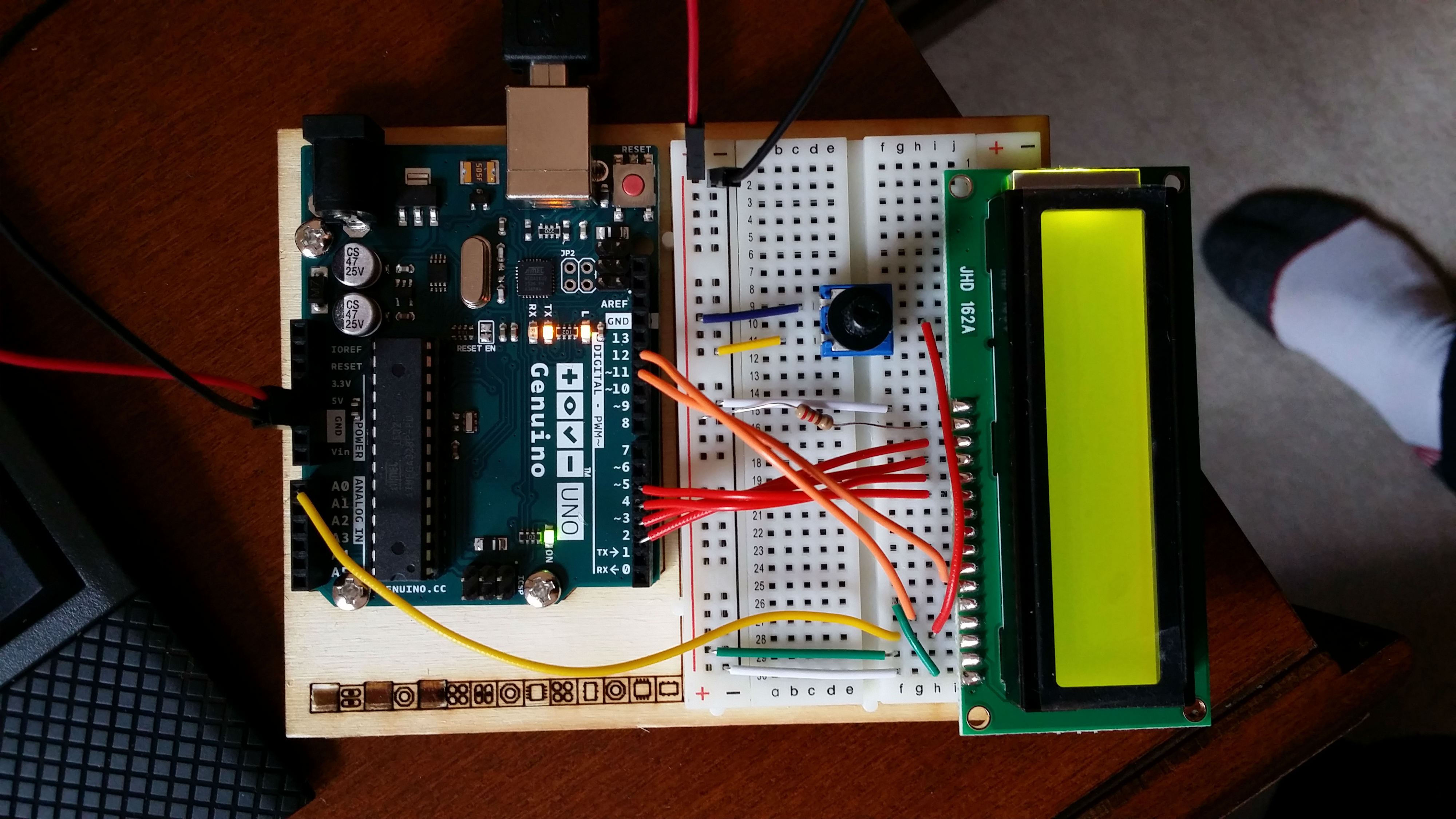

Hi All,
first post here :)
Just bought Genuino Starter Kit and wanted to see how to control the supplied LCD.
Using "Crystal Ball" project as a starting point, I stripped it down to a minimum, just to light up the LCD and write a line on it.
Connections are basically as in the cited project:
  • D4..D7 on the display to P5..P2
  • RS/EN to P12/P11 on the Genuino board.
Other connections:
  • LED- goes to GND, LED+ to 5V through a 220Ohm resistor
  • VCC goes to 5V, VSS to GND
  • R/W to GND (write mode)
  • VEE (called V0 in the book, it's marked VEE in the display PCB): at the beginning I pulled it to 5V. Then, since I was not seeing anything, I connected the potentiometer (10k) and tap its voltage from there. I do not have a VMeter right now so I am feeding the pot tap back to A0 and doing a serial.print(analogRead).
    I can thus see the different voltages and they look "OK".
However, the LCD does not show a single character. It's just bright green :-)

Attached please find a pic of the connected board.
I'd be glad to know that I am missing something basic and not that I have to return the LCD...
Any help greatly appreciated, thank you in advance.
Mike
The voltage at pin 3 will typically be less than 0.5 volts with respect to GND in order to see anything on the display. If you pull it to +5v your display is guaranteed to be blank.
Most datasheets show the ends of the pot connected to +5 and GND (pins 1 and 2) and the wiper connected to pin 3. In order to get the required contrast voltage the wiper will be quite near (or at) the GND end of it's range.
After connecting the power and contrast and before running your sketch you should adjust the contrast until you see a single row of dim boxes on the top row of your display.
You probably should remove the yellow wire between A1 and LCD pin 3 and get rid of the stuff in loop() until you get the display working.

Thanks Don for your reply, and of course between men of taste like us I appreciate your comment on my trendy socks :slight_smile:
I should have read the DS for the display, then I would have known that you need a relatively low voltage to see anything, as you say.
The yellow wire and the rest of the code isn't harming anything of course, just reporting on the read voltage wherever I decide to hook up one end of it (the other being A0).
I probably wasn't clear enough in that I did have the pot on, but could not find any position yielding to visualization.
The reason? Pot is lousy quality and does not produce 1/10 division very reliably. I went on and picked up the next one from the box and...Everything works fine now! Check the pick :slight_smile:

Paul will be here soon to tell you you can use a smaller pot, wired as a rheostat, between pin 3 and GND to get a finer adjustment. A fine adjustment really isn't necessary as the range of acceptable values is quite broad.
I guess you have figured out by now that the -4.5v shown on the datasheet for the typical voltage at pin 3 is measured with respect to the +5v supply.
