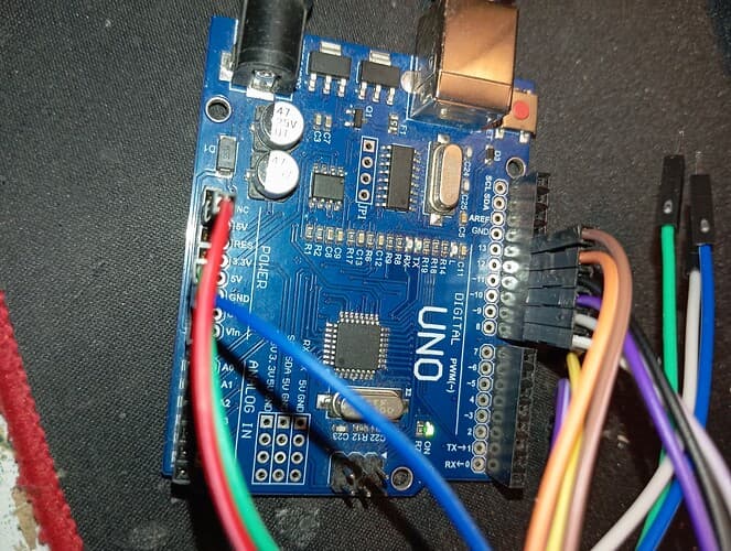

here:
The pin numbering on the screen does not appear to correspond with your document in post #1. For example, the document states that Vcc is screen pin 9. On your breadboard setup the red wire goes to pin 1 which also appears to correspond with the pictures in the vendor link. I have what appears to be a similar screen to yours but th 2.8" version. I had to connect a 10k resistor between screen pins Vcc and Reset to get it to work. I also use Adafruit's ILI9341 libraries with mine.
see I connected it like this:

And it only shows me when I press the reset button
Did you try this:
it's stil not working
What happens if you connect the resistor as I said but disconnect the wire between the screen reset pin and the Uno pin 9. This is also used for savinģ one Uno pin.
When you said this, did you mean you saw your text on the screen when you pressed a reset button?
Very strange but it does appear that the text is getting somehow from the Uno to the screen. It is just not visible until a reset of the Uno.
