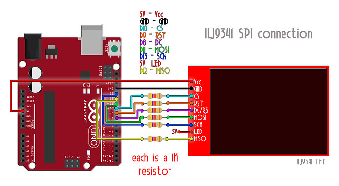

Hi guys, I'm posting this because i tried everything and sill not sure what is happening.
Following this:

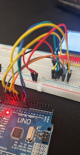

With all of this, getting a white screen. The resistors are all 1k.
Thanks in advance
The ILI9341 is normally a 3.3V logic level display, not sure how well it behaves when fed with 5V logic level signals for the UNO.

In the end, if you are in the same case as me, i ended buying an ESP32 instead, with a 3.3v logic directly. Without resistances. Thanks a lot for the replies!
