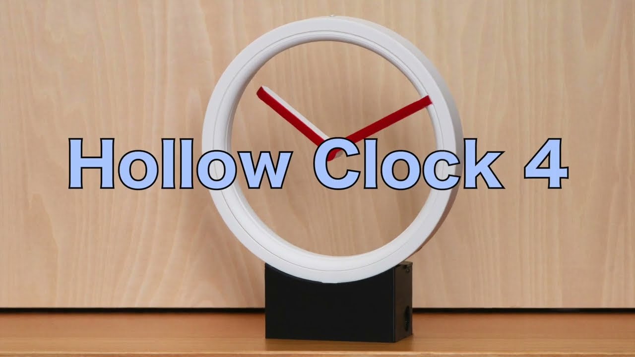

Not really, just remembered some guy on YT stirring chemical solutions using magnets...
And i have seen the Hollow Clock 4 recently, lol
Also, got my first magnetic USB cables few days ago...
Random assotiations about magnets, hehe
