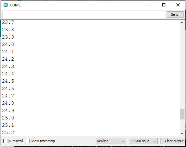

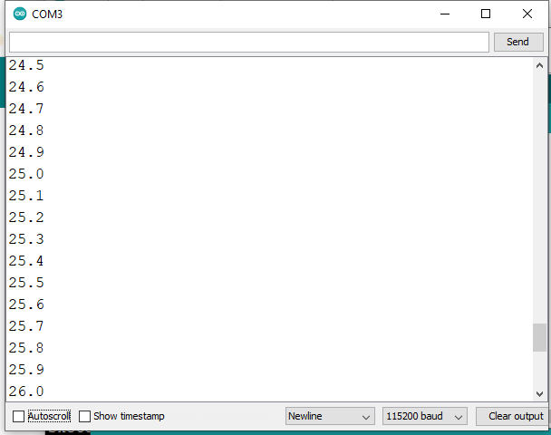

@septillion
The logic of @johnwasser is a heck easier to understand than all the HEX nonsense.... Although your method is basically fine, the implementation is wayyyy overcomplicated.
This is the output for the codes of @johnwasser that you have supplied (Is it working!?).
This is the output for the codes of @septillion that you have supplied (Is it working!?)

@GolamMostafa I see perfectly working code
Hint, it was you who made the implicit requirement for reset @ 24h
Something you probably don't want if we talk run time of a compressor. And if you want a reset, that's the easy part as I showed in the simplified version of your method.
septillion:
Fine! If the @OP wants to keep registering the accumulated run time, then codes both of @septillion and @johnwasser are working alright.

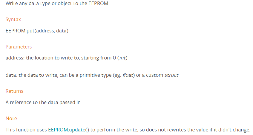

@ryan_brown17 As @StefanL38 suggested in reply #1 and we (the rest) all agreed upon is that it's easier to keep track of deci-hours (aka, 1/10th of an hour) and just insert a decimal point when needed.
Is it with a reason you keep 'elapsedTime' and 'runTime'? Aka, do you want to display both total runtime and current runtime?
And yeah, by using EEPROM.put() the value is only written when it changed.

//update EEPROM is needed
EEPROM.put(EeAddress, totalRunTime / 10);

Did test it with Serial only, so hope stuff is set right for lcd now
