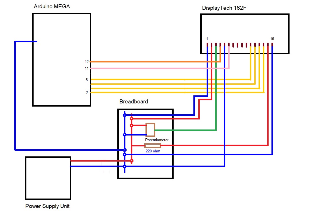

Hi
I am having a problem getting a DisplayTech 162F to work with an Arduino MEGA. the first problem I perceived to be lack of voltage I could only get just over 4 volts from the Arduino board so I put in the extra power supply which feeds the Arduino MEGA board with power as well as the Breadboard. I now have 5 volts on both boards.
I ought to at this stage say that the code and circuit have been validated in as much as the code and circuit work with another LCD display but will not with the 162F. See pictures.
Anyone else suffered this problem ??
any help gratefully received
"Does not work" conveys no useful information. Are there any blocks displayed? Does the backlight come on? Does the contrast adjustment have any effect?
Hi, sorry for my lack of description, the back light works fine, however I cannot see any text regardless of how the pot is set.
Occasionally I see what i can only describe as random noise it shows parts of a block but nothing resembling text. I cannot see the grids constantly, nothing except a blue screen.

Why don't you post a photo and let us double check your wiring.
A 'wiring' diagram such as the one you provided in your original post is supposed to depict the actual physical location of the connections on the devices. Yours shows pin 1 near the left edge of the board and pin 16 closer to the center.
The 'mechanical drawing' on page 7 of the datasheet that I downloaded shows pin 14 near the left edge of the board and pins 1, 15, and 16 closer to the center.
I suspect that the majority of your wiring (all except the backlight) is exactly backwards.

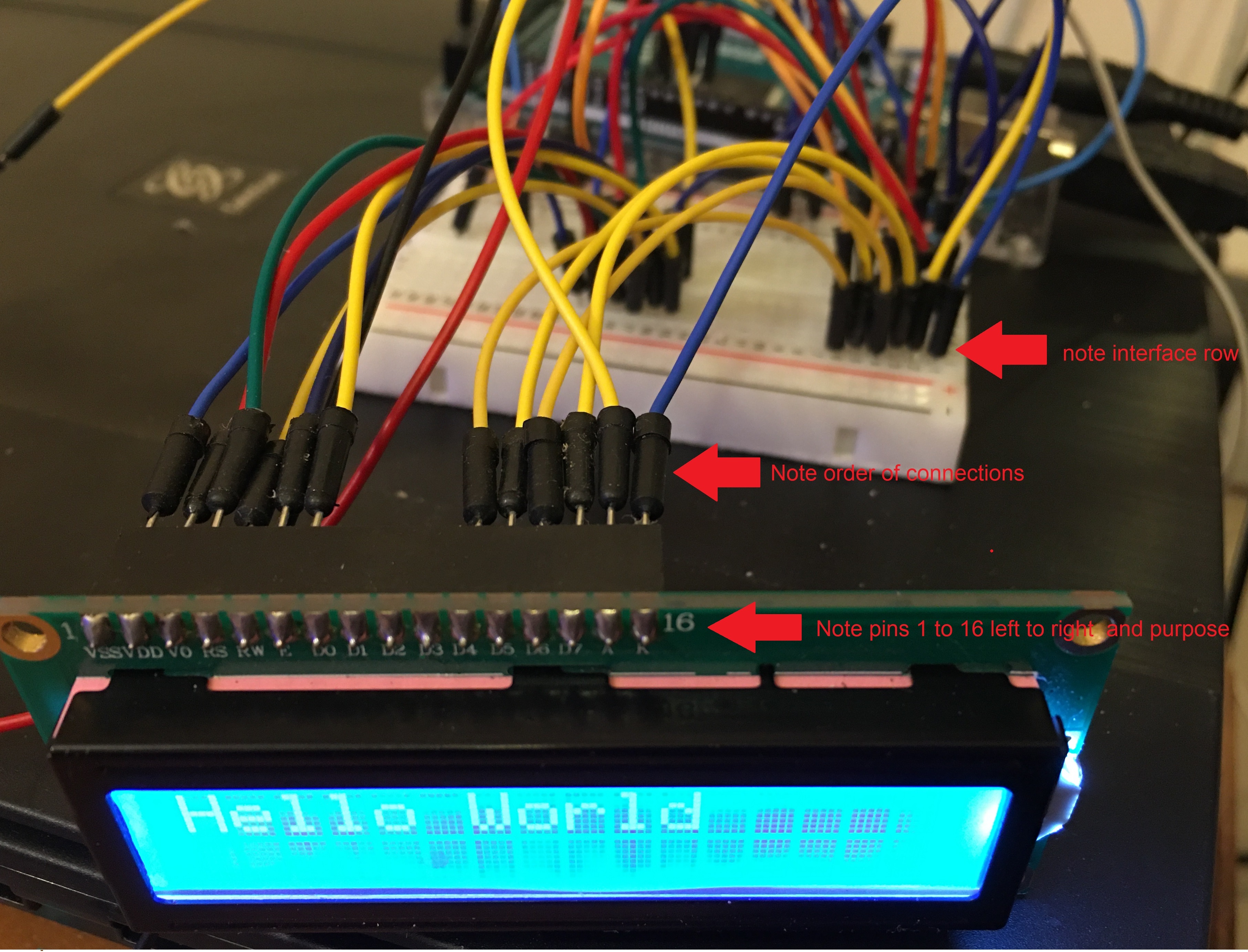

Hi Everyone, I am back from my travels but still have the same problem my display won't work.
I have attached the code and the wiring diagram ( file called header) I have successfully run a 'standard' LCD using this circuit and program file IMG_0357.jpg .
The order of the connections on the interface row on the pin out board follows the order of the connections on the Display from left to right pins 1 to 16.
I then have substituted the Displaytech display leaving everything else untouched. IMG_0354.jpg shows the interface row with both displays detached.
Image file IMG_0370.jpg shows the Displaytech display in place. As far as I can ascertain the wiring is correct and the program is correct. To me that suggests in initialisation problem ( library problem ) or a hardware problem with the display .
I cannot attach all files as the Forum limit is rather low, drop me an email address to see photographs
regards
Les Collier

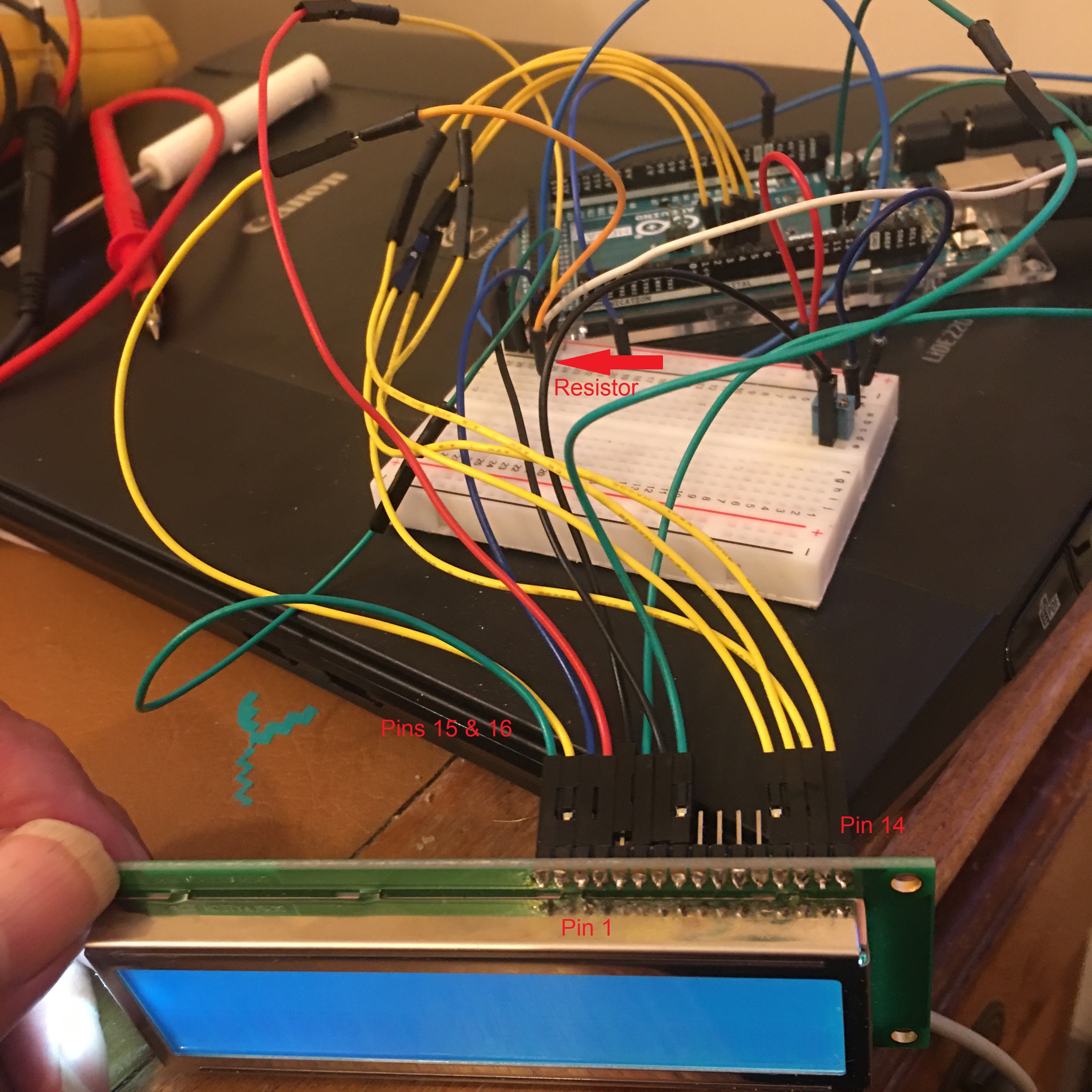

Hi I think I finally managed to get a photo of the wiring
Only you can make any sense out the rats nest.
The LCD is upside down. Not easy to read.
I can't see any external electronics. When you consider that the LCD has 6 signals + 5V + GND, it does not need that many wires.
David.
Les_Collier:
I think the yellow wire is connected to the wrong pin.
Unless the photograph of your connections allows us to unambiguously follow each wire from one end to the other it really doesn't help us determine if the connections are correct.
Don

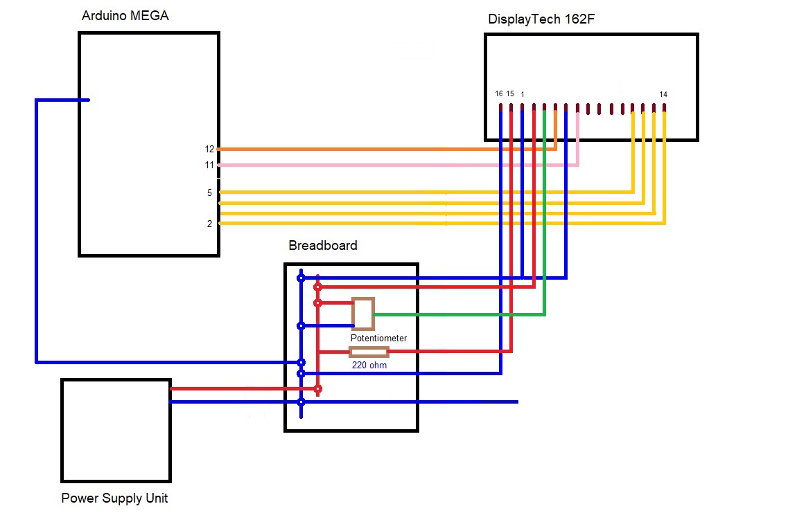

Hi
in desperation I have stripped out all surplus wiring from the circuit leaving the bare minimum. Still no luck display does not work.
Photograph of circuit attached.
regards
LesC
Seriously, you could plug the display straight into the breadboard.
Then you just have 8 male-male jumpers to the Arduino headers.
pull the breadboard and Arduino to straighten the jumper wires.
the photo would be very clear. we could identify individual wires.
you were successful in #11. Even though you had an atrocious rats nest.
Wire it neatly. You will spot errors. Or readers' eyes spot errors.
If the wiring is verified but you get no display, chuck it. Buy another one.
