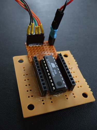

Not really an ISP but I built it and it works great.
http://www.instructables.com/id/Ghetto-Programming%3A-Getting-started-with-AVR-m...
Now thats ghetto, but i like it.....good for breadboard work.
