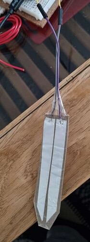

Hello, trying to develop a simple capacitive moisture sensor with two parallel strips of aluminum and hook it up to my ESP8266. Have made the circuit work with a 10uF capacitor but I get no reasonable values with my homemade one.
I used this site as a starting point with R=10Mohm.

With this code and setup I don't seem to be able to charge the capacitive sensor and receives the maximum (constant) value of 28 for the analog pin during charging. Have tried several resistors ranging from 10Kohm to 20Mohm but can't figure out where it fails.
Can you show a picture of the DIY capacitor?
The foil is mounted on a piece of cardboard and everything is held together with household tape.
Sorry, but your homemade capacitor is about 1/1000 the 10uF that worked for you. Perhaps a lot less.
