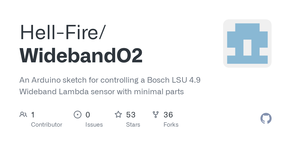

I know the lamda has 4 connectors, power, earth, signal and heating element but I need to take the feed from the signal line through the ADC.
Anyone got an idea what I can use for the ADC?

I dont think you understand what I'm after, I have an analogue signal (the signal from the exhaust gas analyser) and NO its not being read by the LPT port thats how it gets into the PC. Before it gets into the PC it needs to be converted to a digital signal.
I need a way of taking an analogue signal and converting it to a digital signal.

Without detailed knowledge of the probe in question, there are zero people in the universe that can spec an ADC from the above data and get it right. I can guess and give you one but it's not going to work. Period.
What's the probe power input voltage and current?
What's the sensor output voltage range?
What's the heating element resistance? How hot does it need to be? How is it controlled?
What ADC sample rate do you need?
What ADC resolution do you need?
What accuracy do you need?
I can keep going but that should be enough for starters. My point is you don't know the above data and even with some research, you probably will not find all the answers. You've said the sensor already has its own analog to digital converter. It feeds a pc. Do you think you're going to replace a pc with an Arduino?

google arduino wideband lambda

All i know there's a some sort of "DynomecWT-6288i data acquisition box" available from Dynomec. It has 8 analog channels supported. Surely its expensive and you could make your own if you know how their software work..
I did my own motorbike dyno with SimpleDyno software. That's free software and there is a ready program for arduino to support few analog signals. I had also PLX wideband hooked to that and it worked pretty well. The program itself is not good as dynomec i think. But have a look at it to get an idea if you can program arduino to work with dynomec too :slight_smile:
