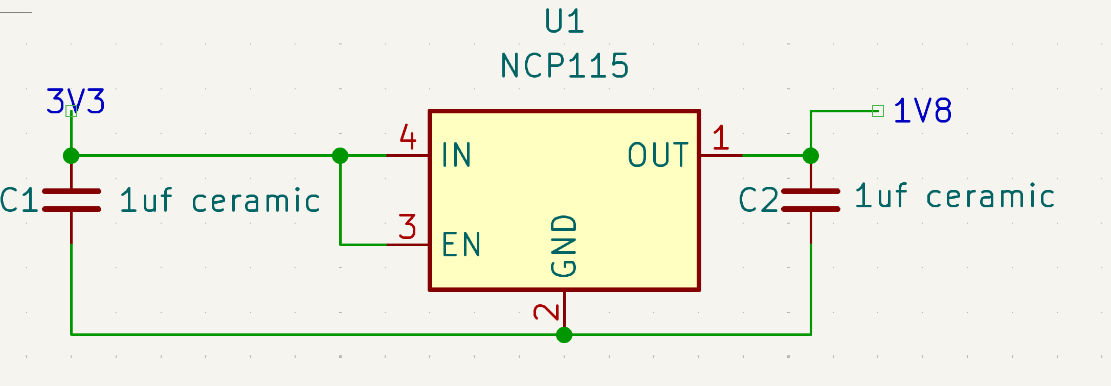

An example of how to get 1V8 from 3V3:

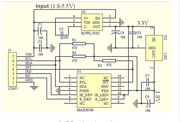

I'll rephrase the question. Did you build a circuit yourself or buy a prebuilt module? Either post a schematic of the circuit as it exists or post the model number of the module.
I bought a prebuild max30100 that I used in a simple circuit
here is an image from internet that is exactly my build

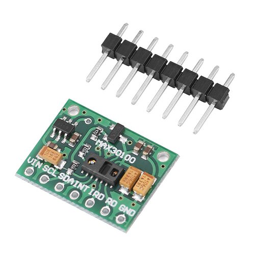

and here is the max30100 that I bought
It looks like the MAX30100 has 4K7 pull-ups to 1V8 on the SDA, SCL lines. That being the case you'll need to level shift its inputs from the Arduino.
I can't tell anything about your display except it is I2C. It probably has pull-ups on SDA, SCL but can't tell what they are pulled up to.
If you have decent schematics for both those modules post them. Also verify what model Arduino it is.
It's a shame the board designer didn't make the I2C pull-up voltage optional because it looks like the MAX30100 inputs are 5V tolerant. That would have made interface easier.
This seems to be the schematic for your module.
