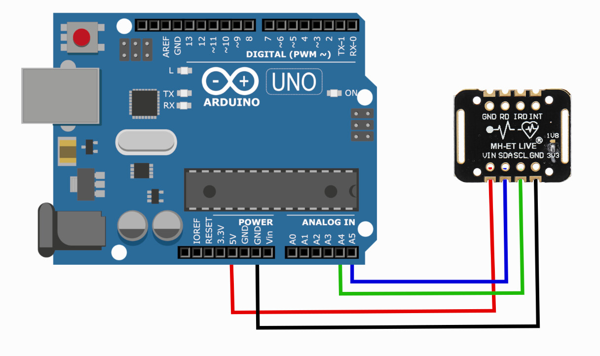

I’m new to robotics. I’m using a MAX30102 (black) heart rate sensor with an Arduino Uno and testing it with the SparkFun library’s Example 5. The wiring seems fine, but the sensor’s LED doesn’t turn on, and the serial monitor keeps saying:
"Initializing... MAX30102 was not found. Please check wiring/power."
What should I do to fix this?
I have bought the sensor from here
Here is the Schematic diagram: (Everything else is connected the same way, except I used the 3.3V pin on the Arduino instead of the 5V pin)

It looks like a schematic from the Internet. In order we could help you, it is important to see your real schematic rather than internet copy. Could you show a photo?
Why did you changed this? Do you change also a logic level jumper on the sensor pcb left to the GND pin?

Do you really want us to help you solve your problem? Lets start with a good schematic showing exactly how you have wired it. It is like you are asking for a map to go from Sigfind to Wisend without any more information other then there will be water and grass along the way.

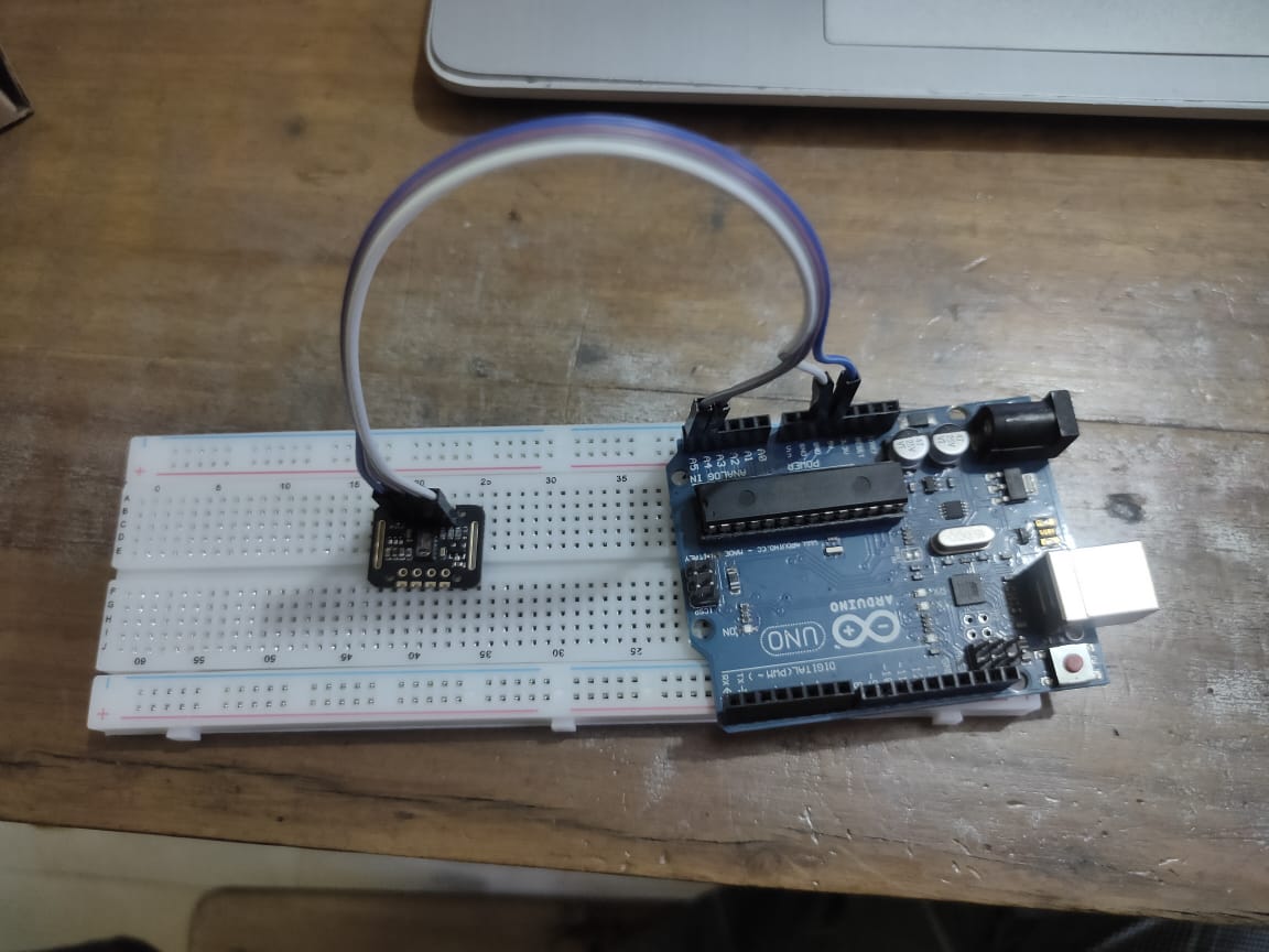

here is the photo of how I have wired the components. I used 3.3V before but when I changed it to 5V, the sensor light turned on for some time and it shows the wave form on serial plotter and values on serial monitor. But when I placed my finger on the sensor the light turned off and shows nothing. After that I removed the usb connection of arduno uno to my laptop and retried but there is no difference. I shows the same output as before
"Initializing... MAX30102 was not found. Please check wiring/power"
Are your pins soldered to the MAX30102 board?

The wiring diagram you show in posr#1 is wrong, you have the SDA and SCL lines reversed.
Also note that the diagram shows the back of the board not the front side.
The header pins must be soldered on, otherwise the connections will be intermittent and unreliable.
So when you touch the device one or more of the connection is probably disconnected.
You must use 5V power!
here is the correct wiring

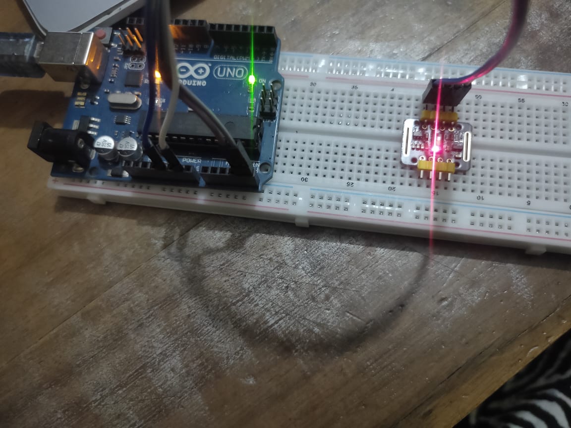

I shared the wrong wiring diagram at first on post 1, but my actual connections were correct. At first, I directly used jumper wires to connect the sensor without soldering. The sensor wasn’t detected, except for a first few seconds of connect and the led turned off when I pressed my finger on it. Thanks for your idea of soldering. I didn’t solder the pins, but I used two header pins on both sides of the sensor and now it works, and I can read data from it. Before, I tried to stick the sensor to the breadboard with just one header pin on the side of jumper wires and the sensor still wasn’t detected. Using two header pins on both sides fixed the problem. Now the sensor is sticked properly on the breadboard.
It will work for a while maybe a day or week but eventually the connections will come loose.
What should I do to prevent this?
Solder pins to module
@zarin12027
As I already mentioned you need to solder the pins
See post #6
