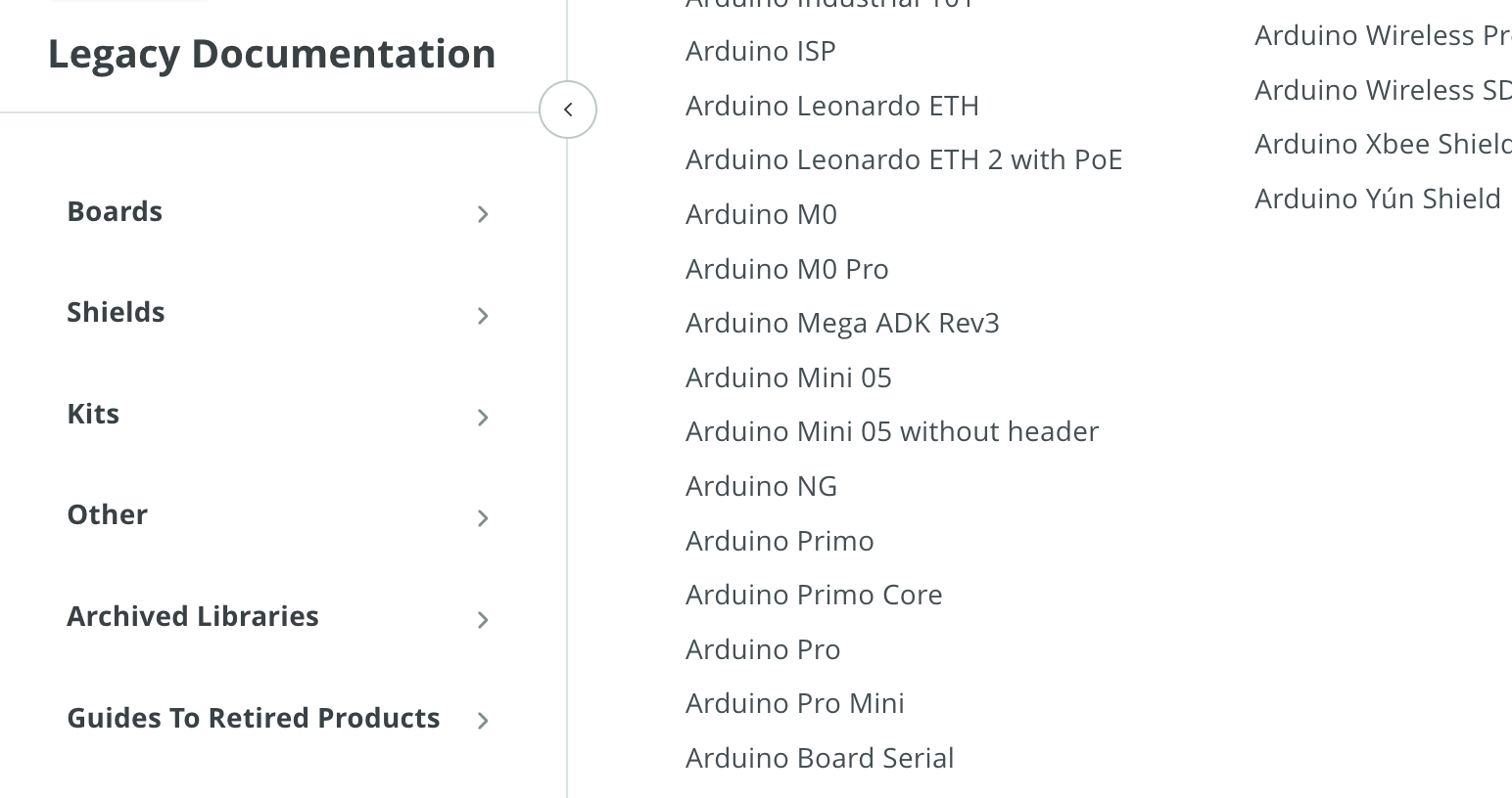

It is marked as retired here, so no wonder if there is some confusion:
https://docs.arduino.cc/retired/boards/arduino-pro-mini/
Good point. I hadn't noticed that. I would guess the documentation team did that just because they don't want to maintain documentation for boards that are not manufactured by Arduino. So it is a manner of the documentation page being retired rather than the hardware being retired.
I meant it's retired by Arduino

Yes, @oqibidipo pointed that out. But that only means the documentation on the arduino.cc site is retired. Arduino doesn't manufacture the hardware so only SparkFun has say over whether the hardware is retired.
