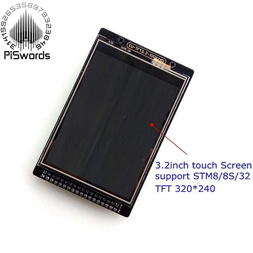

@Jean-Marc,
Do you have any 34-pin displays?
David.

Hi David,
I have several 34pin displays, and as far as I remember, I could read from all of them.
But I don't know if I have this one, I need to check. I will answer later.
Jean-Marc
see:
my_3.2_TFT_320x240_ILI9341_STM32F4.h
my_3.2_TFT_320x240_ILI9341_STM32F407ZGM4_FSMC.h
I am quite sure they are readable, but would need to check.
I would be 99.95% confident that they would work too.
However the AvrFreaks OP does not reveal his AVR C code. Since his display writes "work" I can only assume that his primitive setReadDir() ... functions are correct.
All the same, I know that I make typos, trivial errors, ...
and I suspect that other people do too.
David.
