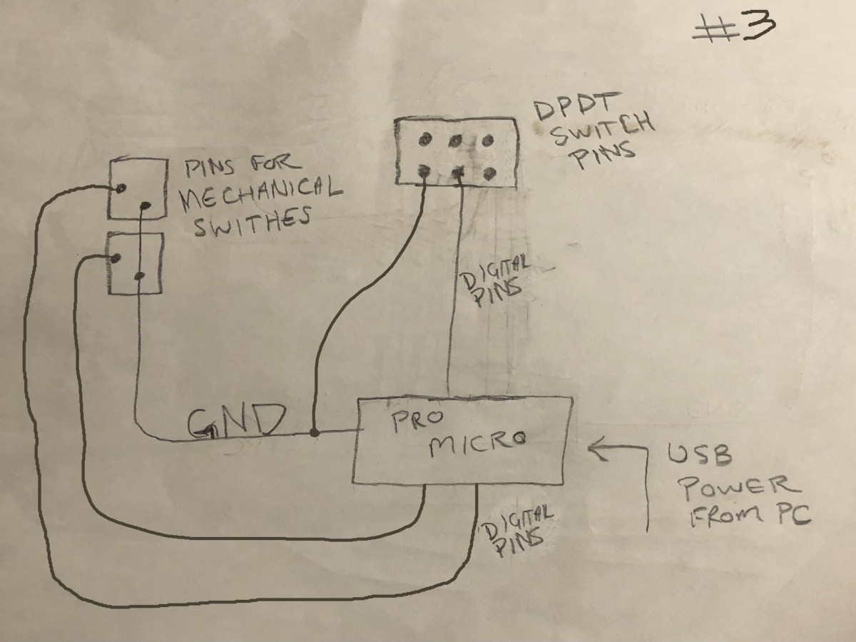

DPDT Switch set up correctly?
Last night I quickly crammed information about toggle switches in order to get some idea for what I plan on doing. Since I am not very savvy with schematics, I instead drew simple diagrams. What I want to do is have two mechanical switches to be toggle-able between two pairs of digital pins on a pro micro board. On one pair of digital pins the switches will signal once per keypress on the PC, and on the other pair of pins they would be programmed so that for every keypress the PC will detect two signals back to back. The PC will see me as pressing the buttons twice rapidly when I still am only pressing them once. I was wondering:
  1. Am I correct that I would need a DPDT switch for this?
  2. Are either of these diagrams correct in how to wire them up?
Well, where I tried to organize...
  1. When you press the any buttons on the left on image, Arduino will send some key to your PC.
  2. The key send twice by if changed the toggle switch.
Is that all right?
If in that case the figure is wrong and you don't even need a DPDT switch.
Additionally, It is a project that can be fully realized even with an alternate push switch.
If you want a toggle switch, the SPST one will suffice.
Or there are a lot of unused terminals, but it can also be used with DPDT.
Because basically upward compatible except for the price and sizes.
I fully respect schematic you drawn and suggest this connection.
I’m just having a hard time understanding the logic of it. The switch in that scenario doesn’t seem to be redirecting the paths the switches would take. I sort of pictured the switch serving like a crossroads where the path to the board from the switches could take one of two paths. I guess I just don’t quite grasp this sort of thing.
First of all, my interpretation of #2 is correct?
Arduino is smart enough to read the state of the toggle switch and change the number of keys sent to the PC when the button is pressed.

In other words, it's like that the button and toggle switch intersected inside the Arduino.
Oh okay I see. Well. I do not know how to code well enough to tell the board to change pin behaviors based on states of toggle switches. I really haven’t hardly ever coded before. So I figured I would use up extra pins and just redirect the mechanical switches to two extra pins which have different permanent coded behaviors instead of using only two total digital pins for the mechanical switches that change based on the toggle switches detected position because I do not know how to do that.
If I had to guess, it would maybe be an if then sort of code where if the circuit connected to the toggle switch is closed, then the pins connected to the mechanical switches would change to signal to the computer an extra time per every switch press. I just don’t know what that code would look like.

My guess based on what tiny amount I think I know, the start of the code for the toggle switch would look like this, and the board would constantly check if the pin for the toggle switch has a closed circuit.
If (digitalRead() == LOW
I just don’t know how to write the code that would come after that to change the pins for the mech switches, but I assume maybe PulseIn or something is involved I don’t know.

At last, what pin did the toggle switch connect to?
I’ll say the toggle will be plugged into digital pin 15. I don’t know if I will keep it to that, but I can always change it.
You seem to be really, really close. That code does cause the switches to trigger twice each per keypress and then stop which is what I wanted, however I was hoping that it would be faster. With what I plan on using the switches for in this game I plan on using them very fast, so they need to squeeze in two inputs per keypress in the amount of time it takes for me to alternate to the other switch, which is a matter of milliseconds. I can alternate between the two switches on this controller a few times just in one second, so the time it takes to cause a second trigger per switch has to be really fast to keep up. I was using the switches in game and was able to press the buttons faster than the code could keep up. But I consider this progress nonetheless lol.
Sorry I may not be as much help as some other people. My knowledge on this stuff is extremely limited. But thanks.
Speed-up faster is not particularly difficult.
Arduino Pro Micro and I can do that if you wish.
By the way, did the new "twice key press" code is it complete work?
If that now it's time to remember the toggle switch before speeding up.
Well... I thought as follows...
Read the toggle switch before reading the button and use "if ~ else ~" to swap the entire button code.
Please expand.

How is it?
By the way, the code is purposely slowed down by me. :roll_eyes:
