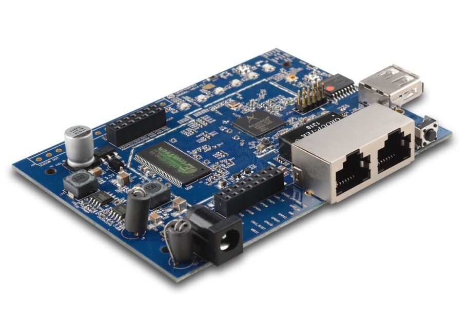

I just got my Dragino MS14 board in the mail today. I plugged in the power cord and the only network that I am seeing is the dragino2-xxxx network and it is a secured network. The "getting started" page is here: Getting Started. Is there anyone familiar with setting these things up to be Arduino Yun compatible? What are the steps involved, the getting started page is not very clear. Thanks.

+1 to looking on Dragino's wiki for the info ! I have the Dragino Yun shield (http://wiki.dragino.com/index.php?title=Yun_Shield) which is plug & play with the Leonardo and will work like a real Yun in that configuration. The MS14 is going to require a firmware upgrade, some level shifters to mach 5V Arduino hardware to the 3.3v Linux side, and a bit of fiddling.
Linux side of Dragino is AR9331 (same as Yun), logic level is 2.5 V instead of 3.3 V. You do not want to fire it.
