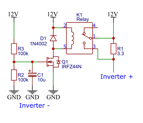

I'm trying to build a soft-starter circuit with 2N2222 transistor.
But I'm struggling to get a fix on the R1, R2 and C1 values.
Now the relay engages as soon as the power up (I see no delay).
I'm trying to come up with 300~500milliseconds delay from power-up to relay engaging.
Datasheet for the relay
Nominal operating current - 80mA
Coil resistance - 62.5Ω
Nominal operating power - 400mW
Could anyone shed some ideas?

I’ve done similar.
A MOSFET (IRFZ44) was used, the resistors were 100k and the capacitor was 10uF. (need to confirm)
The time was ≈ 1 second.
Add a 68 Ω resistor to your relay if you only have a 5v coil.
Your capacitor is wrong way up.
Maybe experiment with a base resistor added.

As stated, if your 5v relay coil is 62.5 ohms, add a 68 ohm series resistor to the relay.
That looks correct, just add the 68 ohm resistor.

Did you try adding a base resistor ?
No. This soft started is for a mains voltage 230v AC appliance. 5v relay, when switches on, it by passes the shunt resistor and supply the full current to the main voltage appliance.

Do you have a 555 timer ?
When does the 5v appear ?

For 5 V, an IRL Z44.
Transistor (BJT) circuit will not work.

thin I have a logic level mosfet somewhere.
Let me try that.
Paul_B:
IRLZ44 logic level MOSFET worked.
