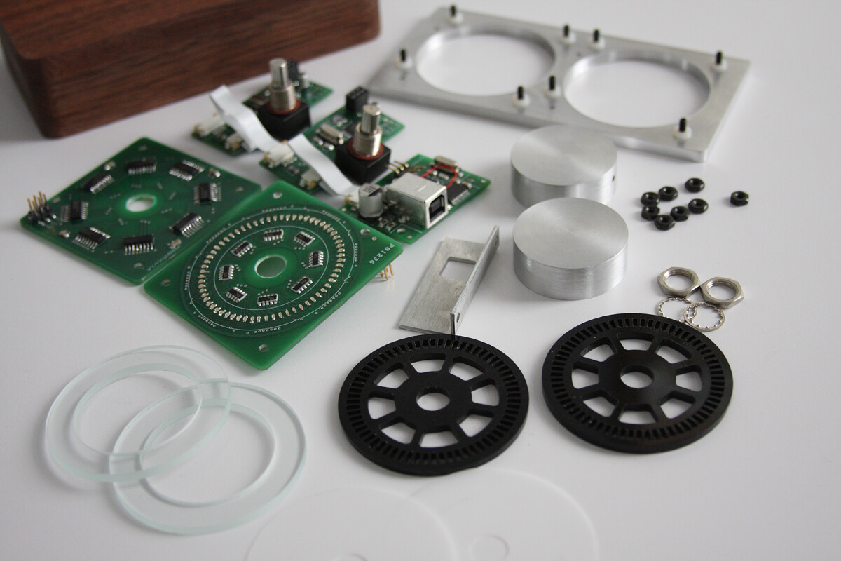

Just found this image looking into what an arc is and what it does
Looks deeeeeep!
Dont actually know if it helps at all, just thought it was cool
Yeah I was looking at that image last night, really wish I could manufacture parts like the black 'cogs' for my project.
Those are just light blockers, s lot of shift registers or led drivers and two pots/encoders, really simple in terms of electronics.
the "cogs" are only necessary if you're using smd leds.

Well, something similar is necessary for my project, as I want to segment the light coming from 60 leds in a circle into individual 'rectangles'. Pretty sure it's possible with a load of black card, but I'm just waiting on all the LEDs to turn up :slight_smile:
