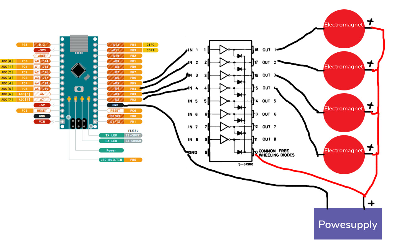

@johnwasser I made a highly sophisticated wiring diagram :smiley: . Is this how you meant it?
Looks good; as long as pin 9 is going to GND.

So I connect pin 9 both to arduino GND and to which pin on powersupply?
Although the ULN2803A can drive 500mA per pin, the total current the chip can drive is (I recall) 2.5amp. Driving 5 coils would hit the total current limit of the driver.
And when energising a coils, you often get an initial current surge, so for frequent switching of 5 coils you might have an overheat (or fried chip) problem. Maybe not immediately.
Maybe split the load over two driver chips.
Total nonsense! :crazy_face:
Guess what 5 times 0.25 is? Ponder it for a moment. :roll_eyes:
News to us! - thinking of filament bulbs or motors or transformers perhaps? Coils have the exact opposite, the current builds up gradually when energized due to the back-EMF - its switch-off that's the issue you have to deal with where a destructive voltage surge is generated if not snubbed or prevented (free-wheel diodes are commonly used for this in DC circuits)
