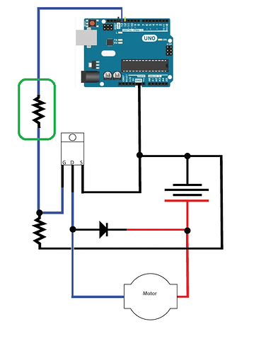

I need to modify the below circuit to drive a relay module using a MOSFET and Arduino. I want to drive the relay module with an external power supply instead of arduino pins. I am unable to see the solution. Need help.
I am using an Arduino Nano, a two channel relay module, and my MOSFET is P90NF03L
Data Sheet MOSFET
STP90NF03L.PDF (254.2 KB)
The question doesn't really make sense.

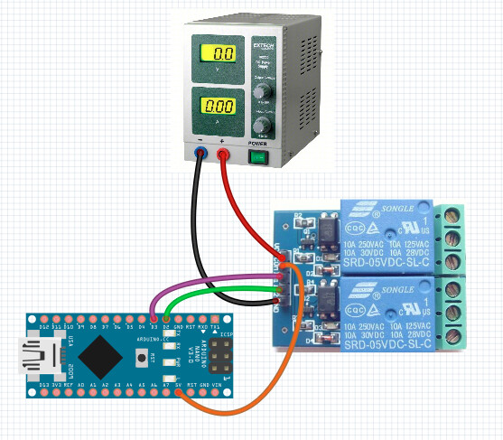

You would wire the Arduino something like this:
To use that relay with a separate power supply, connect like this:
No MOSFET needed
