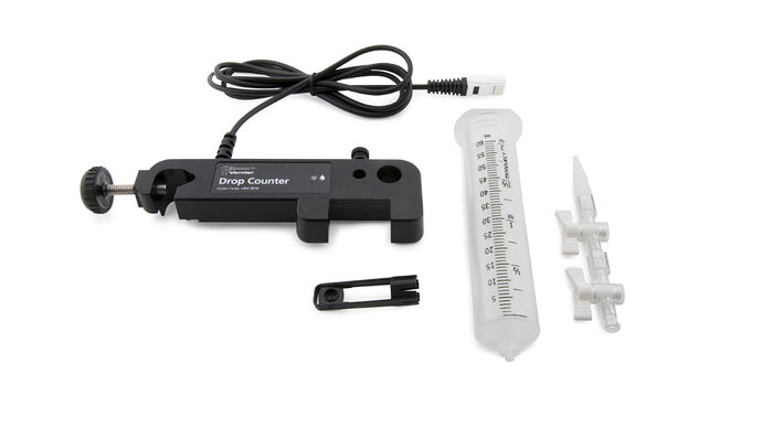

So i had the idea to count drops and after researching i found this one:
All i found here is: Drop counter - Frequently-Asked Questions - Arduino Forum
But the one from Vernier does not look like it uses IR (plastic closed).
So the idea is to use a funnel with something at the bottom that only let drops out
and count them.
Some ideas what the best way is to count them?
If you can organize for the drops to break a light beam between an LED and a photodiode that would probably be simplest - no contact and no contamination.
I presume you will have a reservoir to hold back heavy rain and allow it to feed as a series of drips. This will mean the drips continue long after the rain has stopped - though it should give you the proper total volume.
What about making your own tipping bucket with a very small bucket fed by a large collector. The advantage is that it allows you to detect the rate of rainfall.
Or you could have a loadcell to weigh the water in the bucket (any size of bucket) and it could empty the bucket when the load exceeded X. That way it would not matter if the rain stopped with the bucket partly full.
...R

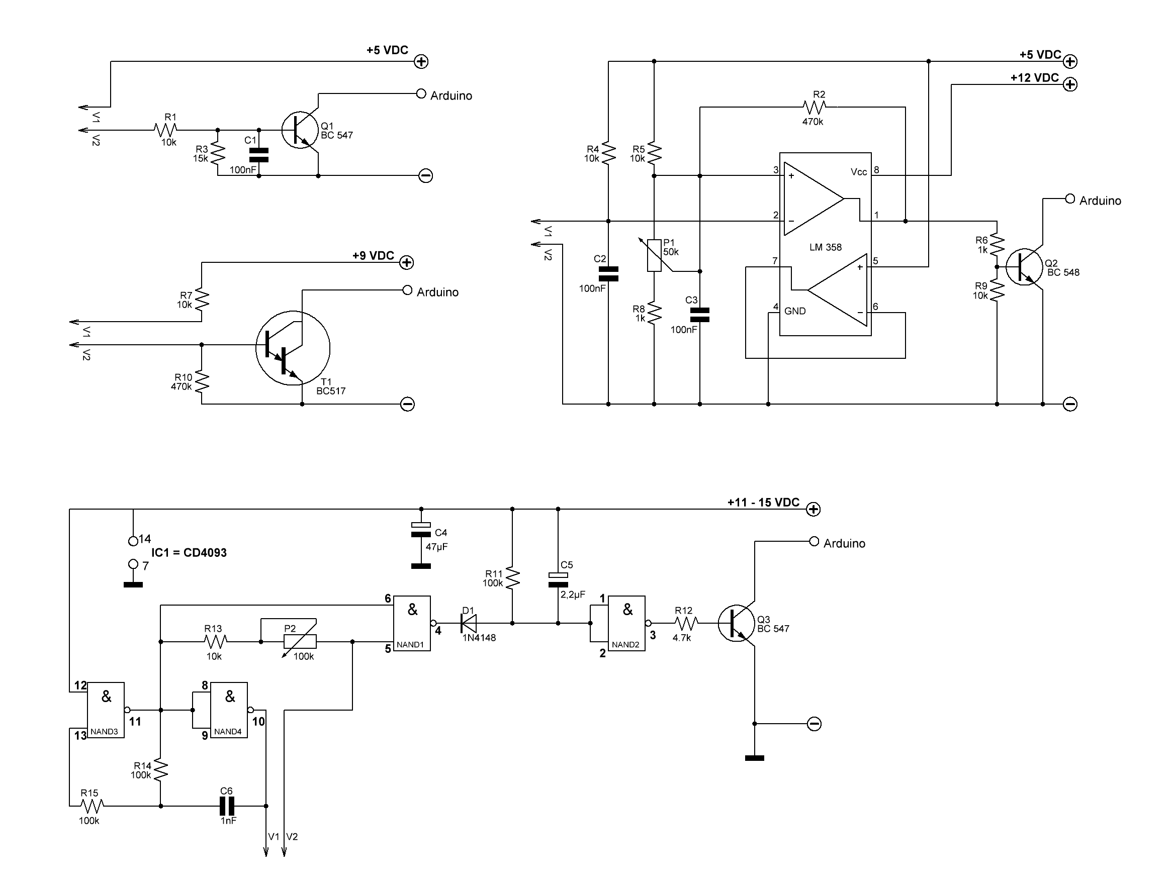

So a funnel on top and the circuit in my attachment should work?
The green, blue, red and orange line is the water drop.
So no matter where the electrical short is it should count.
I have now 3 different water sensor circuits (attachment) - The one with CD4093 switches on if it gets dry.
Not sure which one is the best.
First i wanted to make it standalone but i have other stuff too so it would
be nice to connect everything to one Arduino in the garden shed.
That means 5-10 meters (19-32ft) and i want to use CAT6 cause
then i can put 1Wire and the water sensor in one cable.
So 12 volt would be best i guess that i don't loss to much power on the thin cable.
Also it would be best if the two sensor wires go from the garden shed to where i need them.
This way i save strands in the cable and can use twisted ones to increase the cross section of the wires.
Ideas, tips, hints?

how come you need to be more accurate than 0.2mm of rain???
if you doubled the catchment area to say 400mm diametre then you would have a 0.1mm accuracy (in theory)
