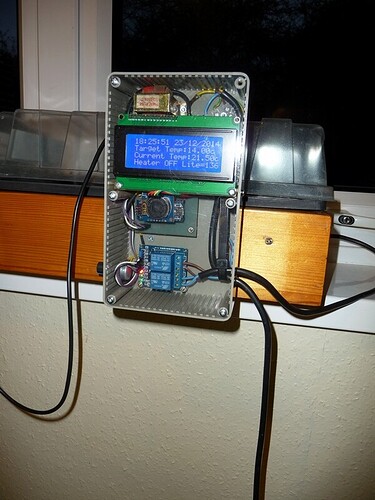

Hi All,
For what it's worth I have used the DS18b20 lots of times, without any problems.
I have just checked the one on my seed propagator with the thermocopule on my DMM and its within 0.42 of a degree. Perhaps check the maths, also how many bits are you reading??
Regards
Mel.
