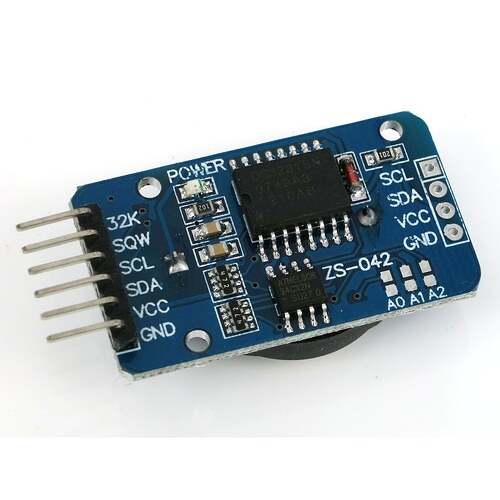

Does the DS3231 have a good battery installed?

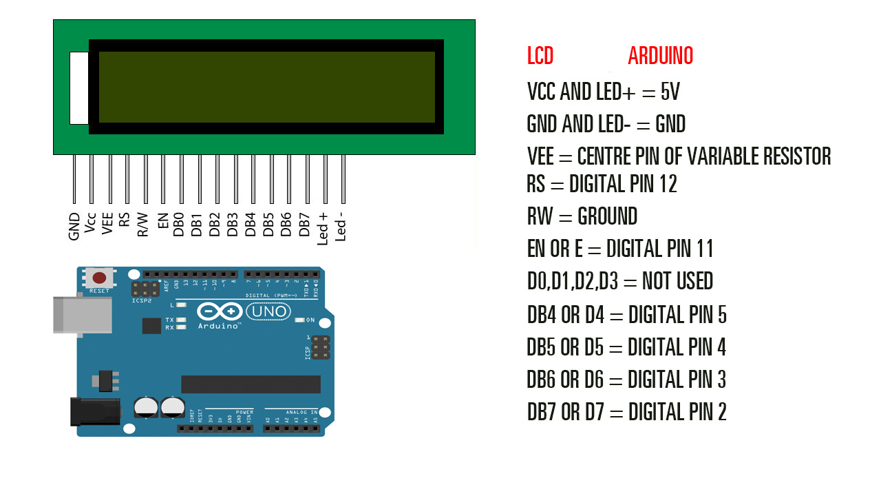

LiquidCrystal lcd(12, 11, 5, 4, 3, 2); //saves 5 pwm pins for servos, leds, etc

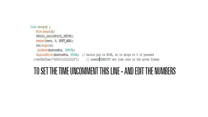

    Wire.begin();
    DS3231_init(DS3231_INTCN);
    memset(recv, 0, BUFF_MAX);
    rtc.begin();
     pinMode(buttonPin, INPUT);
    digitalWrite(buttonPin, HIGH);  // button pin is HIGH, so it drops to 0 if pressed
  //setTheTime("305017101012018");     // ssmmhhDDMMYYYY set time once in the given format

    Wire.begin();
    rtc.begin();
    setTheTime("305622107112023");     // ssmmhhDDMMYYYY set time once in the given format
  lcd.begin(16, 2);

I did the initial setup but nothing has changed, it continues where it was when the power is cut.
OK, are you saying that is just freezes when power is cut and it resumes where it left off when power is restored? It's not incrementing the clock when on battery power? Not resetting to zero when power is removed.
It continues where it left off, the time does not increase when running on battery power, when the power is cut off, it restarts from whichever minute the hour was left.
From the DS3231 datasheet:
Bit 7: Enable Oscillator (EOSC). When set to logic 0, the oscillator is started. When set to logic 1, the oscillator is stopped when the DS3231 switches to VBAT. This bit is clear (logic 0) when power is first applied. When the DS3231 is powered by VCC, the oscillator is always on regardless of the status of the EOSC bit. When EOSC is disabled, all register data is static.
EDIT: I quoted the wrong part of the manual
vcc gnd scl sda depend
Read here how to set the control bits:
https://arduino.stackexchange.com/a/91588
