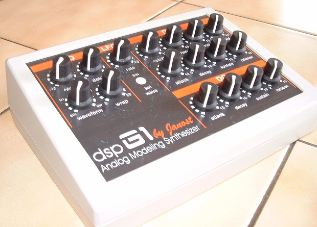

It's time to show a real synth.
It has 12 DCO, 1 LFO, a 24dB DCF with resonance and 2 ENV.
The audio is 44.1KHz, 16-bit resolution.
The sound is not done by an ATmega, it only scans the pots and keyboard.
It's done by a DSP, a 48-MHz 32-bit ARM.
So where's the demo video? I'm ready.
It's coming.
All It plays's at the moment is a C4 3-key chord with a filter sweep at power on.
That's why I'm building the front panel board :slight_smile:
The board is just a 4067 analog MUX to scan the frontpanel pots for synth parameters and send them over to the DSP by TTL-MIDI..
It can also scan a keyboard, pitch-bend and trig/CV inputs for the synth.
Keeping track of presets in it's EEPROM, run Arpeggios etc.
The DSP runs an analog model of a synth, reading the parameters over TTL-MIDI on one pin and outputs the audio on another pin.
