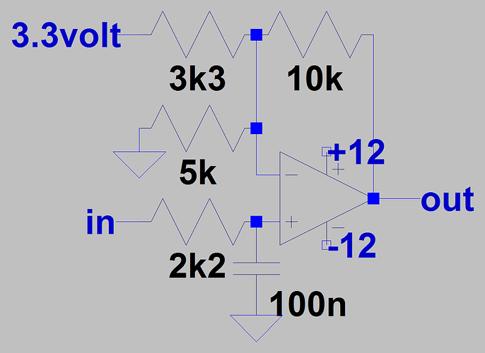

I'm working on a flight simulator and need to use our Arduino Due to send -10V to +10V to a hydraulic pump that controls the pitch and roll on the simulator.
Could I achieve something like this using the DUEs built in DAC and scaling up the voltage with an op amp?
If this would work, I could really use a schematic and parts list to follow. I'm more of a programmer than an electrical engineer.
Any help would be appreciated.
Here's a video of the project so far.
I assume you're asking for a ±10volt signal for a motor driver, not a ±10volt to drive the motor. Attached example diagram will do that. You need a bi-polar ~12volt supply, with decoupling on the opamp (not drawn). The 5k resistor can be 2*10k in parallel.
Leo..

Note that DAC0 and DAC1 output a signal within the range 1/6 * 3.3V and 5/6 * 3.3V.
IMO, you should firstly fix the range "issue" and afterwards the bipolar issue.
Mixing the Wawa answer above and this blog should send you to the right track:

If someone can make the modification I would be grateful. Does the Due never output 0V if you set analogWrite(DAC0, 0)?
Hackmodford:
See page 1412 of Sam3x datasheet.
Change the 10k into 15k, and the 5k into 4k3 (standard 1% metalfilm E24 values).
That will get you close with a D/A range of 1/6 to 5/6.
Almost any modern cheap opamp should do.
Check that it can do the ±10volt swing on a ±12volt supply.
Leo..

I had to add a .1uf capacitor to the output of the schematic to get rid of some noise from a power supply. Does this change the offset? Because now I'm getting -7 to 12 as the range.
Although I'm not familiar with this opamp in general you should not drive a high gain amplifier straight into a capacitor especially one as high as 0.1µf.
I suggest you put a 0.1 cap from the +12V to ground and another from the -12V to ground. If you still have noise you can add resistor at the output of the amplifier of the order of 100 ohms then add a 0.01 cap. You might get by with a 0.1 after the 100 ohms but I'm not sure with this amp.
Note when I say at the output I mean after the 10k feedback resistor. If your input is low impedance the 100 ohms could be a problem but its likely you are driving a high enough impedance so the 100 ohms will not cause you an issue.
