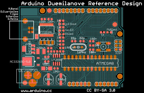

I bought a PCB kit of the duemilanove on eBay here, cgi.ebay(dot com)/Arduino-Duemilanove-bare-PCB-Kits-/280492300875?cmd=ViewItem&pt=LH_DefaultDomain_0&hash=item414ea4da4b" i received the package and am getting ready to solder everything on. it didn't come with any directions and i was wondering where i could find out what the locations are for the different yellowish color surface mounts go, they are separated in the package but i just don't know where they go. I know where the 102 and 103 ones go by looking at photos but have no idea where the others go. can someone help me, i cant find anything on Google for it.
The small "yellowish" SMT components with no markings are the ceramic capacitors. You should have a set of two 22pF caps that get put on the PCB near the crystal, and a set of 9 100nF caps that go in all the other capacitor spots...

so do the set of two caps goes above the crystal or to the right of it?

The 22pf caps go "above" the crystal. Perhaps this will help?
Yea this really helps thanks! i did expect a kit rather than just a collection of parts so you were right about that too. Thanks all of you for your help.
