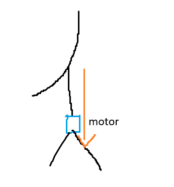

I think I may have miscommunicated how this is working? The project is to study the movement and habits of bird species. We are using a servo motor and a rotating parabola mic. The mic (and dish) are perpendicular to the ground, in that case the motor wouldn't have to constantly provide torque as there is no opposing motion after the dish has been turned?
Gravity.
Wait a second, am i messing something up really badly or wouldn't the force just get transmitted down?
Am I being horribly stupid?
