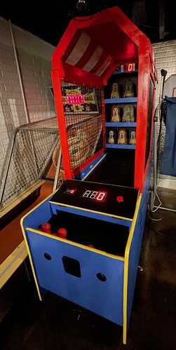

This is a working project that I wanted to share with the forum as so many of you contributed to the various programming aspects that allowed me, a novice, to successfully write working code. The code is shown below. NOTE: I am not necessarily looking for any help whatsoever but thought several of you would enjoy knowing that your help made this possible.
Click here for YouTube video

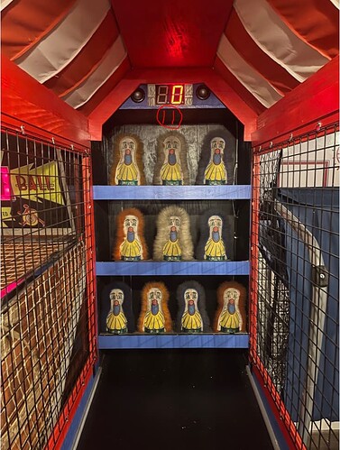

My arcade game is similar to a game called "Down the Clown". If you are not familiar with it, the player throws balls at 10 clown targets and scores points when each clown target gets knocked down. When an entire row is knocked down, that row resets after some time passes. This continues for a total of 30 seconds and then the game ends.
The cabinet was handmade using parts either I had lying around or purchased from Home Depot. For the most part, all the electrical components were purchased from Amazon.
The clown targets were salvaged from two arcade games that must have shot balls using an air cannon. Those games had been in a warehouse fire. The original cabinets were severely damaged but the clown targets, air cylinders, and solenoids were only smoke-damaged. You should have seen the clowns before they were cleaned.

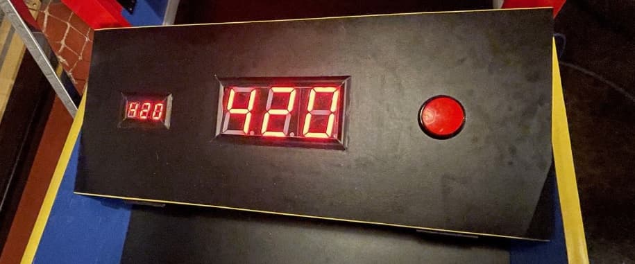

The outside of the control panel looks like this:
The inside of the control panel looks like this:
  1. Hand-made PCB board needed to simplify wiring to the individual seven segments on all the eight displays (three digits for score, three digits for high score, and 2 digits for time). This board also incorporates resistors to manipulate the 12 volts incoming voltage from the power supply and reduce it to 7.2 volts needed for the large 3" displays
  2. Hand-made PCB board made up of resistors to further reduce the 7.2 volts coming out of the larger PCB board and reduce it to 2 volts needed for the small 1" displays
  3. Power supply that offers three voltages (5V, 12 V & 24V) needed for various components
  4. Two MP3 players
  5. Two amplifiers for the MP3 players
  6. Arduino Mega
  7. Relays to convert microprocessor signals to 5V needed by the start button light and 24V needed for the air cylinder solenoids
  8. Back side of 3 digit display (1" tall) for high score
  9. Back side of 3 digit display (3" tall) for score
  10. Back side of the start button with LED light
  11. 2 digit display (3" tall) for the time remaining (not shown... see photo above)
