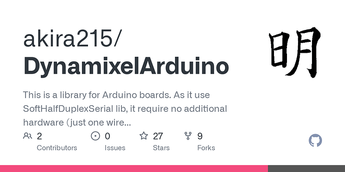

Hello to everyone,
I just finished to write a Dynamixel library for Arduino. There are many libraries to drive Dynamixel actuator, but i didn't find any that required no additional hardware (or they have some limitations).
Mine is just as simple as connecting one pin ! (take care that it should support change interrupt, see the readme file in SoftHalfDuplexSerial lib).
feel free to clone the github :

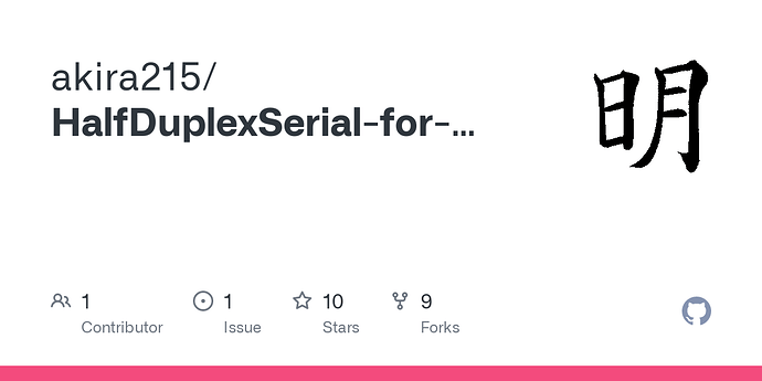

This library inherits from SoftHalfDuplexSerial, available here :
I basically hack a little the "official" SoftwareSerial library to allow it to switch Tx and Rx on one pin. The timing is quite important during this kind of operation, unfortunately, my logic analyser die during the development (10$ chineese one :confused: ). I run it out with success at 115200bps, but I faced some communication errors at this speed, so I think that 57600bps is a great deal.
All the required hardware and software help is available in the github wiki page. There is an axemaple for each of the lib, you just have to clone in the arduinox-x-x/libraries folder and run it.
Basically to get it work, construct a dxl object, start com using dxl::begin method, and play with your servo !
dxl dxlCom(8); // Construct a dxl object using pin 8 to communicate
dxlCom.begin(57600); // Start Communication at 57600bps
dxlCom.setGoalPosition(1, 1000); // Servo ID 1 will move to 1000
As I have only one AX servo, all my tests have been carried out with one servo connected. I assume that it could work with many AX servo daisy-chained, please let me know if anyone can test that.
Hope that it will help.
Regards

Sorry for the late answer, I was away.
I just updated the libs (the two ones). There was a mistake in the error routine, it was correted (in the example .ino file).
Please check what error you get with the new lib, it will be easier to help you.
Regards

Hello,
Before running the example, you have to paste the entire the library directory in your arduino folder (i.e. /opt/arduino-x.x.x/libraries on linux, I don't know the correct path on windows).
The include path of Arduino IDE is setup to seach header in this directory.
Regards
Hello Akira,
The second library isn't available, SoftHalfDuplexSerial.
Is it possible to re-upload the library.
thanks
Hi Sonekaka,
Sorry, I changed the name of the repository because I wrote an interface using an abstract class, to be more reliable.
You can clone this github :
Regards

Hi mtete,
Do you install halfDuplexSerial lib (see the first post of this topic) ?
In addition what board do you use ? Is there a Serial1 port on it ?
hdSerial1 is instanciate in halfDuplexSerial Lib, only if the board you are using have a Serial1 port.
Regards
I juste added support for Arduino Due.
The RS485 tranceiver enable is drive by the RTS pin on Due, so the HalfDuplex serial lib has changed :
SoftHalfDuplexSerial is not yet supported for the Due board, it could be but I have to take some time to tweak it. If anyone is interested, let me know.
The repository is still the same :
Regards
