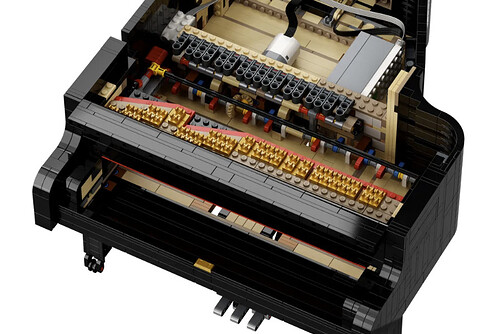

So I want to modify this lego model Grand Piano 21323 | Ideas | Buy online at . The existing self-playing mechanism only plays a couple of notes in a fixed loop. This is impressive for a lego model. But maybe it can be improved further:)
This is the existing mechanism, controlled by a camshaft:
Each solenoid needs to be strong enough to lift one of the key mechanisms:
Ideally everything should fit in the body. Although I can build a larger one, after all it's just Lego :slight_smile:

An idea to think about/experiment with that might solve your space issues.
Glue a small neodymium disc magnet under each key, where the cam protrusions lift them currently (I assume this is under the red coloured part of each key seen on the pictures you attached?)
Place a small electromagnet under each key. When energised with the correct polarity, this should repel the disc magnet, pushing the key upwards.
I'm not sure, but it might be possible to use inductors of some sort as the electromagnets.
Or maybe make a line of iron nails in a strip of plywood or something that can be laid under the keys with a nail pointing up at the disc magnets under each key. Wind a small coil around each nail to make them electromagnets.
You should spend some time testing and experimenting, because without a moving core like a solenoid, the field produced by the electromagnets may need to be quite strong to repel the magnets sufficiently, and may also repel the discs on the adjacent keys.
